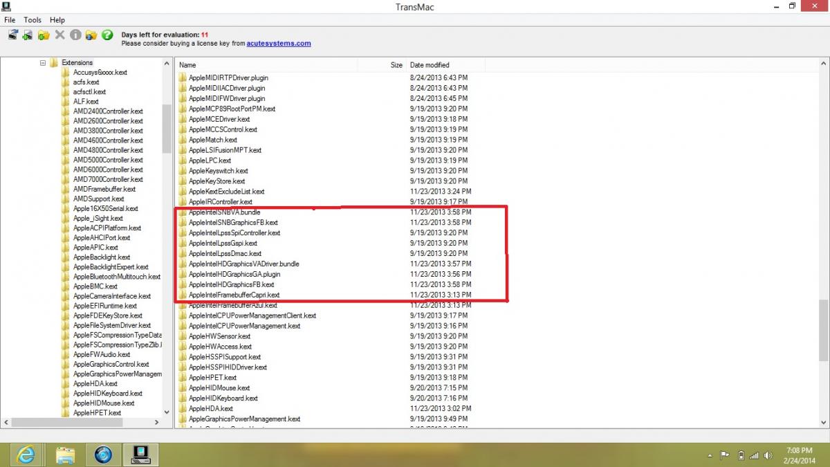

carbo178 Posted February 25, 2014 Share Posted February 25, 2014 If your laptop has a pentium b processor you need to delete the Intel video kext from the installer and start with -v GraphicsEnabler = No.The integrated video card is not supported, i don't think you have graphics acceleration Link to comment https://www.insanelymac.com/forum/topic/296343-mavericks-install-on-asus-laptop-stuck-when-booting-installer/#findComment-1997170 Share on other sites More sharing options...
funderburgh22 Posted February 25, 2014 Author Share Posted February 25, 2014 Which one should I delete there are a few. Link to comment https://www.insanelymac.com/forum/topic/296343-mavericks-install-on-asus-laptop-stuck-when-booting-installer/#findComment-1997174 Share on other sites More sharing options...
carbo178 Posted February 25, 2014 Share Posted February 25, 2014 Delete all kext AppleIntelSNB***, AppleIntelHDGraphics*** and AppleIntelFramebuffer*** Link to comment https://www.insanelymac.com/forum/topic/296343-mavericks-install-on-asus-laptop-stuck-when-booting-installer/#findComment-1997177 Share on other sites More sharing options...
