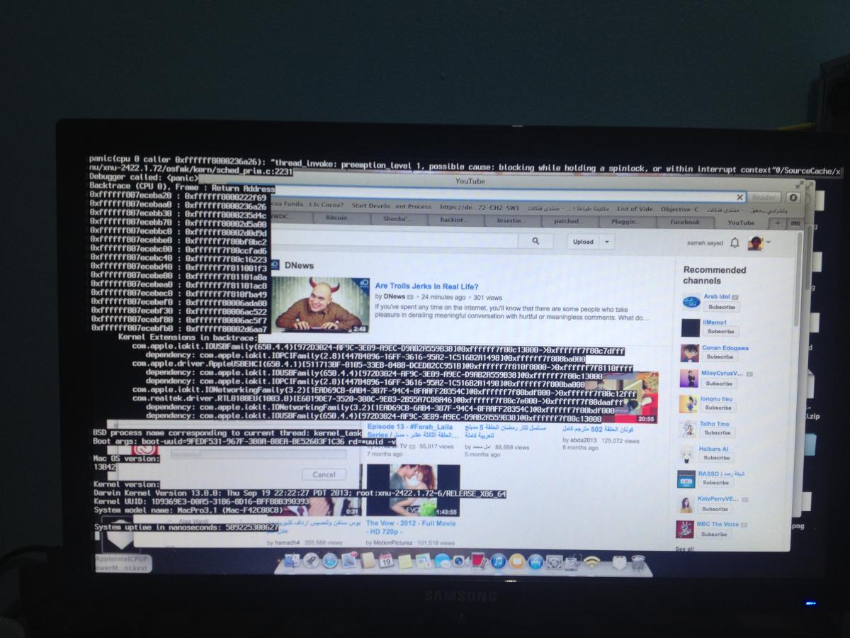

so i've TP Link TL-WN723i used the Kexts in this post
http://www.osx86.net...5n-v2-usb-wifi/
it worked ( for most part )
when downloading or using transmit large files from internet ( > 100 mb ) at high speed it freezes the Entire system .
i Tried Ethernet and it works but the USB wifi still freezes the device i can see it clear when listing to iTunes Radio and download Adobe creative cloud app this freezes in a matter of moments .
i have a wireless keyboard and mouse , when they're plugged with the usb wifi the freezes happens but if only one of them of connected (The keyboard or The usb ) Nothing happens . so it seems some sort of power problem .
This a Pic of what i get using 10.8 Power management (cause using 10.9 it doesn't write anything just freeze )
