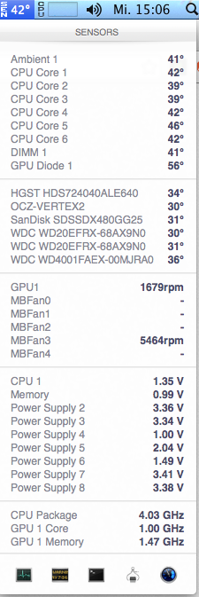

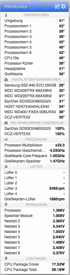

DaveVegas Posted February 12, 2014 Share Posted February 12, 2014 Hey guys!After updating to Mavericks I noticed that my temps were higher than usual. Installed HWMonitor and it shows me that my overclocked CPU is now at 4.03 GHZ (in ML i OC'd to 4.5ghz) and it has higher temps than in ML.I've heard that this has to do with DSDT and SSDT. I attached mine in this thread, is there anything you guys can do?My board is a Sabertooth x79, with an overclocked i7 3930k (x32 multiplier, blck 126.5) (actually multiplier is higher but mavericks only supports up to x32 multiplier)Also I have "Generate P states and Generate C states" in my boot plist and it says that it couldn't generate them. Also I get the message that I have unsynchronized tsc for cpu :SSpeedstep doesn't seem to work either, just have 2 states (I have NullCpu installed, without it I get KP).Any help?Mavericks runs fine, it's just the messages I get in the beginning and the higher temps that keep worried.Let me know!ThanksDavePS: I tried generating my own ssdt and dsdt but I think I didn't suceed. I also attached my generated dsdt/ssdt in this thread. I'm afraid of using them because I get two warnings in ssdtPRGen which are "cpu-type may be set improperly 0x0501 instead of 0x0601" and "system-type may be set improperly 3 instead of 0" - I have no idea how I can make these warnings go away.I can't afford to loose my machine so I hope you guys can help me!PPS: I also attached my temperature readings which are at IDLE modes. PPS2: I also attached my boot.plist and smbios.plist - Maybe they can help too!Thank you so much!DavePPS3: Here are the messages I receive in the beginning:Here you can see that it doesn't generate any P or C states. In this you can see how NullCPUPowerManagement starts working, the processor gets detected by AppleACPICPu but then later it says "Unsynchronized TSC for CPU 1-11" (even though I have voodoTSC for my processor 3930k 6 core)Here you can see that somehow /dev/rdisk2s2 (NO WRITE) that there is a no write error? The rest looks fine to me, what do you think?Here you can see that there is some kind of "Sound assertion" in AppleHDAController at line 1303, 581 and 352. What does that mean? Audio works fine but sometimes it crackles. Is there anything I can do?Also important is to see that AppleIntelCPUPowerManagement seemed to have timed out (probably because of NullCPU?) again, what can I do?Also it says that it "failed to set c-state demotion data: -1"After that it boots up fine. Let me know what I can do! I always like to give back to this community and hope that someone will and can help me!BestDave plists.zip my_own_dsdt_ssdt.zip dsdt_ssdt.zip Link to comment https://www.insanelymac.com/forum/topic/296020-higher-temps-on-mavericks-cp-states-not-working-speedstep-not-working-sabertooth-x79-w-i7-3930k/ Share on other sites More sharing options...
