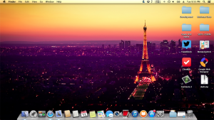

ashishpatelmac Posted February 12, 2014 Author Share Posted February 12, 2014 We did it. Now I have a fully working Hackintosh! For sleep, I Patched dsdt device RTC. and it worked Thank to everyone in osx86 community and carbo178 (insanelymac moderator) who helped me personally fixing errors in dsdt and patching. The purpose of this thread is completed. I have fully native power management with intel speedstep. working sleep, now I can get back to work as soon as I open lid on my laptop. One again thanks to everyone. This topic maybe closed now. -attached working dsdt and ssdt for lenovo g570 intel i3 2330M dsdt.aml.zip ssdt.aml.zip 1 Link to comment Share on other sites More sharing options...
carbo178 Posted February 12, 2014 Share Posted February 12, 2014 Good!!! I was going to suggest that you apply the patch for RTC, but you were good at it alone Link to comment Share on other sites More sharing options...
