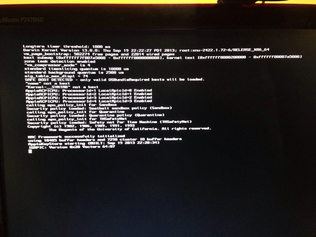

phantom_83 Posted January 4, 2014 Author Share Posted January 4, 2014 Ecco fatto il pasticcio! Ho inserito il dsdt in extra e dopo aver riavviato si blocca alla schermata di avvio. Link to comment https://www.insanelymac.com/forum/topic/294664-aggiornamento-a-mavericks-da-ml-185/page/2/#findComment-1981912 Share on other sites More sharing options...
Fabio1971 Posted January 4, 2014 Share Posted January 4, 2014 All'avvio digita -v DSDT=No Fabio Link to comment https://www.insanelymac.com/forum/topic/294664-aggiornamento-a-mavericks-da-ml-185/page/2/#findComment-1981914 Share on other sites More sharing options...
