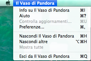

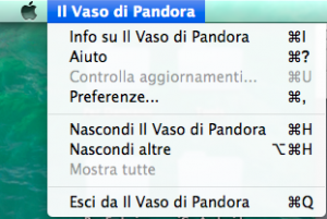

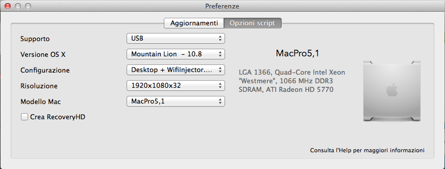

Stucas Posted December 15, 2013 Author Share Posted December 15, 2013 smbios, risoluzione schermo ecc ecc da dove li imposto scusa??? sono un po rinco oggi!!! Link to comment https://www.insanelymac.com/forum/topic/294368-problemi-mountain-lion-su-acer-aspire-4730z-e-su-acer-aspire-v5-531/page/4/#findComment-1975985 Share on other sites More sharing options...
carbo178 Posted December 15, 2013 Share Posted December 15, 2013 Dovresti averli impostati durante la creazione della chiavetta con Pandora Link to comment https://www.insanelymac.com/forum/topic/294368-problemi-mountain-lion-su-acer-aspire-4730z-e-su-acer-aspire-v5-531/page/4/#findComment-1975993 Share on other sites More sharing options...
Stucas Posted December 15, 2013 Author Share Posted December 15, 2013 assolutamente non me li ha mai fatti creare forse solo la prima volta che ho provato... premetto che creo la chiavetta da un pc, ma devo installarla in un altro!!! Link to comment https://www.insanelymac.com/forum/topic/294368-problemi-mountain-lion-su-acer-aspire-4730z-e-su-acer-aspire-v5-531/page/4/#findComment-1975999 Share on other sites More sharing options...
carbo178 Posted December 15, 2013 Share Posted December 15, 2013 Ma i passaggi di Pandora sono obbligati, a meno che tu non imposti tutto da Preferenze Link to comment https://www.insanelymac.com/forum/topic/294368-problemi-mountain-lion-su-acer-aspire-4730z-e-su-acer-aspire-v5-531/page/4/#findComment-1976004 Share on other sites More sharing options...

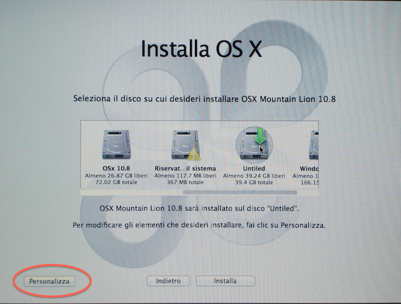

Stucas Posted December 15, 2013 Author Share Posted December 15, 2013 ok trovata!!! questa operazione devo farla prima o dopo di creare la chiavetta?!?!?! Link to comment https://www.insanelymac.com/forum/topic/294368-problemi-mountain-lion-su-acer-aspire-4730z-e-su-acer-aspire-v5-531/page/4/#findComment-1976008 Share on other sites More sharing options...
carbo178 Posted December 15, 2013 Share Posted December 15, 2013 Questa operazione va fatta prima; automatizza la creazione della chiavetta Link to comment https://www.insanelymac.com/forum/topic/294368-problemi-mountain-lion-su-acer-aspire-4730z-e-su-acer-aspire-v5-531/page/4/#findComment-1976015 Share on other sites More sharing options...
Stucas Posted December 15, 2013 Author Share Posted December 15, 2013 perfetto!!! ultima cosa prima di salvare,,,con questa configurazione...che tipo modello di mac dovrei scegliere??!?! Acer 531-21174G32Mass, Aspire V5. Processor clock speed: 1.8 GHz, Processor family: Intel Pentium, Processor: 2117U. (é un dual core 64bit) Internal memory: 4 GB, Internal memory type: DDR3-SDRAM, Memory layout: 1 x 4 GB. Total storage capacity: 320 GB, Storage media: HDD, Hard drive capacity: 320 GB. Display diagonal: 15.6 ", Display resolution: 1366 x 768 pixels, Aspect ratio: 16:9. On-board graphics adapter model: Intel HD Graphics macbook 2.1 potrebbe andar bene? configurazione? quale delle 4 laptop devo scegliere? Link to comment https://www.insanelymac.com/forum/topic/294368-problemi-mountain-lion-su-acer-aspire-4730z-e-su-acer-aspire-v5-531/page/4/#findComment-1976016 Share on other sites More sharing options...
carbo178 Posted December 15, 2013 Share Posted December 15, 2013 MacBookPro 8,2, Laptop 6 o 8 (la seconda o la quarta dei Laptop) Link to comment https://www.insanelymac.com/forum/topic/294368-problemi-mountain-lion-su-acer-aspire-4730z-e-su-acer-aspire-v5-531/page/4/#findComment-1976025 Share on other sites More sharing options...

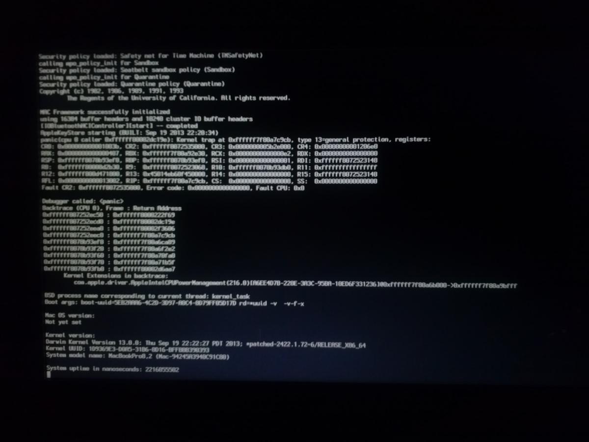

Stucas Posted December 15, 2013 Author Share Posted December 15, 2013 sta installando, ed è partito senza ne -x o -v o -f che sia!!! già un buon segno!!! Link to comment https://www.insanelymac.com/forum/topic/294368-problemi-mountain-lion-su-acer-aspire-4730z-e-su-acer-aspire-v5-531/page/4/#findComment-1976048 Share on other sites More sharing options...
Stucas Posted December 15, 2013 Author Share Posted December 15, 2013 installato tutto ancora nulla... -x niente, -v niente, -v-f-x nulla Link to comment https://www.insanelymac.com/forum/topic/294368-problemi-mountain-lion-su-acer-aspire-4730z-e-su-acer-aspire-v5-531/page/4/#findComment-1976063 Share on other sites More sharing options...

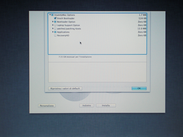

carbo178 Posted December 16, 2013 Share Posted December 16, 2013 Quando hai installato nella parte personalizza hai scelto di installare bootloader, kext e programmi? Link to comment https://www.insanelymac.com/forum/topic/294368-problemi-mountain-lion-su-acer-aspire-4730z-e-su-acer-aspire-v5-531/page/4/#findComment-1976165 Share on other sites More sharing options...
Stucas Posted December 16, 2013 Author Share Posted December 16, 2013 ...provo e vi dico... che voci dovrei selezionare in bootloader, kext e programmi? tutte? Link to comment https://www.insanelymac.com/forum/topic/294368-problemi-mountain-lion-su-acer-aspire-4730z-e-su-acer-aspire-v5-531/page/4/#findComment-1976323 Share on other sites More sharing options...
carbo178 Posted December 16, 2013 Share Posted December 16, 2013 Bootloader, nelle opzioni metti i moduli; kext NullCPU e FakeSMC; programmi tutti Link to comment https://www.insanelymac.com/forum/topic/294368-problemi-mountain-lion-su-acer-aspire-4730z-e-su-acer-aspire-v5-531/page/4/#findComment-1976350 Share on other sites More sharing options...

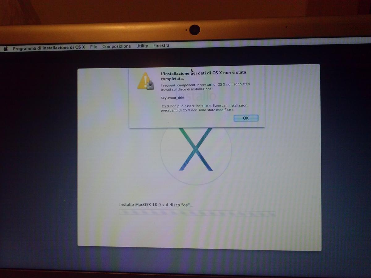

Stucas Posted December 17, 2013 Author Share Posted December 17, 2013 rifatto l'installazione da zero con le sole opzioni scritte da carbo e il risultato purtoppo è questo.... Link to comment https://www.insanelymac.com/forum/topic/294368-problemi-mountain-lion-su-acer-aspire-4730z-e-su-acer-aspire-v5-531/page/4/#findComment-1976429 Share on other sites More sharing options...
carbo178 Posted December 17, 2013 Share Posted December 17, 2013 Elimina il modulo keylayout.dylib dalla cartella Extra/modules Link to comment https://www.insanelymac.com/forum/topic/294368-problemi-mountain-lion-su-acer-aspire-4730z-e-su-acer-aspire-v5-531/page/4/#findComment-1976451 Share on other sites More sharing options...
Stucas Posted December 17, 2013 Author Share Posted December 17, 2013 non è nella cartella extra...mi compare quando metto i flag in qualche opzione su personalizzaprima che installo! Link to comment https://www.insanelymac.com/forum/topic/294368-problemi-mountain-lion-su-acer-aspire-4730z-e-su-acer-aspire-v5-531/page/4/#findComment-1976568 Share on other sites More sharing options...
Stucas Posted December 17, 2013 Author Share Posted December 17, 2013 -di FakeSMC ci sono solo i plug in!!! - se nelle opzioni metto tutti i moduli mi da quell'errore se installo con i valori di default (ossia bootloader, opzioni dei boot e applicazzioni) al riavvio dopo l'installazione mi da sempre l'errore di appleintel... eccecc Link to comment https://www.insanelymac.com/forum/topic/294368-problemi-mountain-lion-su-acer-aspire-4730z-e-su-acer-aspire-v5-531/page/4/#findComment-1976593 Share on other sites More sharing options...
carbo178 Posted December 17, 2013 Share Posted December 17, 2013 Vai di default (bootloader e opzioni del boot senza i moduli, Applicazioni), ma metti anche NullCPU Link to comment https://www.insanelymac.com/forum/topic/294368-problemi-mountain-lion-su-acer-aspire-4730z-e-su-acer-aspire-v5-531/page/4/#findComment-1976596 Share on other sites More sharing options...

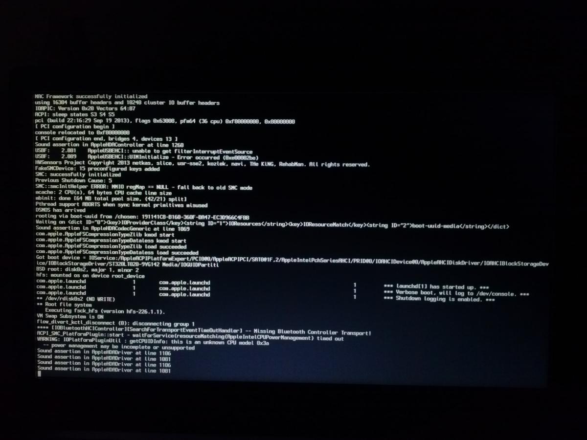

Stucas Posted December 18, 2013 Author Share Posted December 18, 2013 devo ancora sistemare i kext. Il boot0 l'ho appena fatto ..ok! l'unica cosa è che devo avviare per forza con -x, altrimenti mi compare questa.... Link to comment https://www.insanelymac.com/forum/topic/294368-problemi-mountain-lion-su-acer-aspire-4730z-e-su-acer-aspire-v5-531/page/4/#findComment-1976714 Share on other sites More sharing options...
