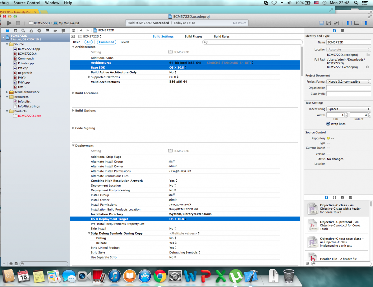

Alex009988 Posted November 18, 2013 Share Posted November 18, 2013 Hum, I went to the URL of the project but the model of my wired card, BCM57786 is not mentioned. Once I download it, before compiling I just need to add 14e4:16b3 somewhere? Also, can you provide a link for Xcode, I would avoid registering with an Apple ID. Thanks, GiuTor Ok. 1) Download Xcode 2) Download sources. http://www.insanelymac.com/forum/files/file/79-bcm5722d/ 3) Open the project and find BCM5722D.cpp 4) Add your device { DEVICEID_BCM57788, "BCM57788 NetLink Gigabit Ethernet" }, { DEVICEID_BCM5784, "BCM5784 NetLink Gigabit Ethernet" }, { DEVICEID_BCM57786, "BCM57786 NetLink Gigabit Ethernet" }, { DEVICEID_BCM57785, "BCM57785 NetLink Gigabit Ethernet" }, { DEVICEID_BCM57781, "BCM57781 NetLink Gigabit Ethernet" }, { DEVICEID_BCM57780, "BCM57780 NetLink Gigabit Ethernet" }, 5) Open register.h and add your device #define DEVICEID_BCM57788 0x1691 #define DEVICEID_BCM5784 0x1698 #define DEVICEID_BCM57786 0x16b3 #define DEVICEID_BCM57785 0x16b5 #define DEVICEID_BCM57781 0x16b1 6) Go to info.plist and add your dev-id to IONameMatch, namely pci14e4,16b3 7) Click blue icon and correct develpment target, sdk, Architectures. 8) Product->Build for->Testing or press Alt+B After find your file Products ->Show in Finder 2 Link to comment https://www.insanelymac.com/forum/topic/293985-kext-for-broadcom-bcm57786/page/2/#findComment-1969481 Share on other sites More sharing options...
giutor Posted November 18, 2013 Author Share Posted November 18, 2013 Ok. 1) Download Xcode 2) Download sources. http://www.insanelymac.com/forum/files/file/79-bcm5722d/ 3) Open the project and find BCM5722D.cpp 4) Add your device { DEVICEID_BCM57788, "BCM57788 NetLink Gigabit Ethernet" }, { DEVICEID_BCM5784, "BCM5784 NetLink Gigabit Ethernet" }, { DEVICEID_BCM57786, "BCM57786 NetLink Gigabit Ethernet" }, { DEVICEID_BCM57785, "BCM57785 NetLink Gigabit Ethernet" }, { DEVICEID_BCM57781, "BCM57781 NetLink Gigabit Ethernet" }, { DEVICEID_BCM57780, "BCM57780 NetLink Gigabit Ethernet" }, 5) Open register.h and add your device #define DEVICEID_BCM57788 0x1691 #define DEVICEID_BCM5784 0x1698 #define DEVICEID_BCM57786 0x16b3 #define DEVICEID_BCM57785 0x16b5 #define DEVICEID_BCM57781 0x16b1 6) Go to info.plist and add your dev-id to IONameMatch, namely pci14e4,16b3 7) Click blue icon and correct develpment target, sdk, Architectures. Screen Shot 2013-11-18 at 22.48.53.png 8) Product->Build for->Testing or press Alt+B After find your file Products ->Show in Finder Ehm which one is the right one? Download BCM5722D_v2.3.5_SL_UB.zip 22.07KBDownload Lion_BCM5722D.kext.zip 22.17KBDownload MavericksBCM5722D.kext.zip 22.07KBDownload ML_BCM5722D.kext.zip 107.66KBDownload v2.3.5soursesBCM5722D.zip Link to comment https://www.insanelymac.com/forum/topic/293985-kext-for-broadcom-bcm57786/page/2/#findComment-1969491 Share on other sites More sharing options...
