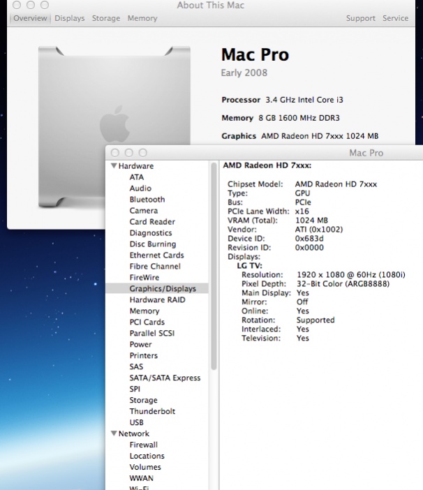

theworstlifter Posted November 5, 2013 Share Posted November 5, 2013 Hi there, This is my first build, so, please, be good to meMy build is:Z77n-WiFii3 - 3245HD7770Everything is perfect despite the facts that there is no audio and the video card appears as HD7770.I am able to boot only with GraphicsEnabler=No. Link to comment https://www.insanelymac.com/forum/topic/293587-hd7xxx-issues/ Share on other sites More sharing options...
k3nny Posted November 5, 2013 Share Posted November 5, 2013 Hi and welcome, for audio look at your board's specification page and find the audio chipset. Most likely it will be a Realtek ALCxxx. You need to find a patched AppleHDA.kext for this specific chipset and inject its layout-id, for example with an HDAEnabler.kext If you don't have any other issues besides the name of the video card, leave it like it is. Alternatively you might want to try to inject different framebuffer settings. Link to comment https://www.insanelymac.com/forum/topic/293587-hd7xxx-issues/#findComment-1963943 Share on other sites More sharing options...
