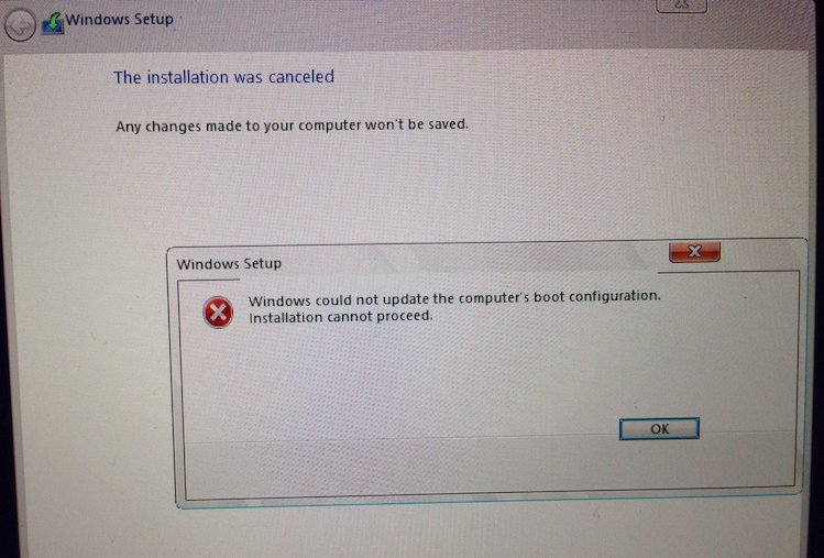

Ridill Posted November 5, 2013 Share Posted November 5, 2013 Good evening, everyone. Machine: Late 2013 MacBook Pro with Retina Display2.6GHz Quad-core Intel Core i7 (Crystalwell) Intel Iris Pro 1024MBNVIDIA GeForce GT 750M 2GB GDDR516GB 1600MHz DDR3L SDRAM512GB Flash Storage OS: OS X 10.9 (13A3017) - Mavericks A few days ago I installed Windows 8.1 from a bootable USB flash drive using Boot Camp Assistant [Version 5.1.1 (479)] and the .iso provided to me by the Microsoft Store on a 50GB partition. Everything worked flawlessly; Windows 8.1 installation, Apple drivers, Windows updates, wi-fi, Office 2013 installation, etc. I soon decided that I would rather have my partition be approximately 100GB (128GB specifically) to allow me more space for when I am in the native Windows environment. Using Boot Camp Assistant, I erased the Windows 8.1 partition and created a new 128GB partition. Installation process was proceeding the same way as the first time, but I received the following error message when the installation was finalizing: "Windows could not update the computer's boot configuration. Installation cannot proceed." and "The installation was cancelled. Any changes made to your computer won't be saved." I then decided to start from scratch. I reformatted my USB flash drive and used Boot Camp Assistant to reconfigure the bootable USB flash drive using the Windows 8.1 .iso. I also erased the Windows partition using Boot Camp Assistant and recreated it with 128GB. Unfortunately, I was stopped at the same point in the Windows 8.1 installation process with the same error messages. This is a bit vexing to me as the only change in the process I have made from the successful Windows 8.1 installation is the amount of space I allotted on the Windows partition (50GB to 128GB). Could this actually be the issue? I have read around a bit on this error message and it appears to be a common reply that this version of Boot Camp Assistant does not support Windows 8.1. I can say with absolute certainty that statement is untrue as I have successfully used it for this purpose already. I greatly appreciate your collective knowledge and assistance. Thank you in advance. Link to comment https://www.insanelymac.com/forum/topic/293565-windows-81-on-boot-camp-partition/ Share on other sites More sharing options...
Ridill Posted November 11, 2013 Author Share Posted November 11, 2013 Well, I ended up reaching a resolution on my own. There is a bug in the current version of Boot Camp Assistant. In some instances, when removing a partition using Boot Camp, it is not completed properly and the disc doesn't unmount completely. This occurs without error message and the partition appears to be deleted in the Boot Camp Assistant. The Disk Utility is unable to correct the error. The resolution is to boot in Internet Recovery Mode. Holding [Command + Option + r] when booting will initiate the internet recovery. Once the latest recovery utilities are downloaded from Apple, select Disk Utility and you will see the partition (labeled "Untitled") that Boot Camp Assistant claimed to have removed. Select the Untitled partition and click erase. Then expand your Macintosh HD to be your entire disk. Reboot. I was then able to use Boot Camp Assistant to install Windows 8.1 on a new partition without issues. I hope this helps those of you that are currently experiencing this error. Link to comment https://www.insanelymac.com/forum/topic/293565-windows-81-on-boot-camp-partition/#findComment-1966628 Share on other sites More sharing options...
