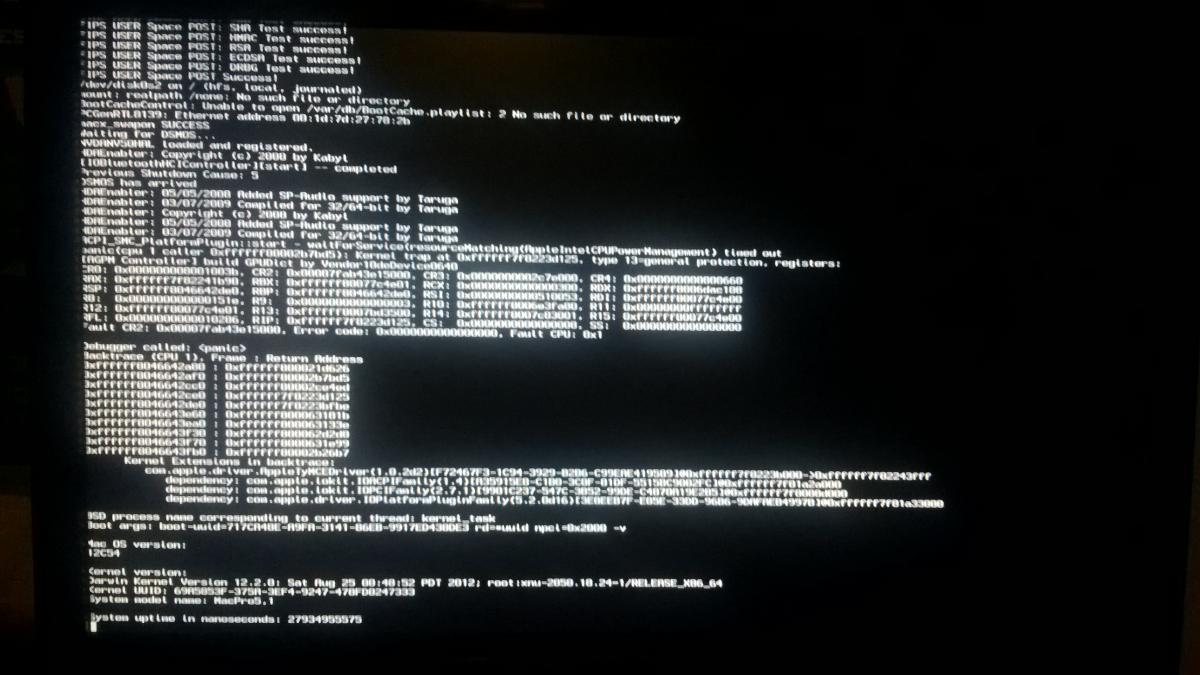

rlf Posted October 16, 2013 Share Posted October 16, 2013 Boot in verbose mode (-v) and when the kernel panic happens, take a picture of the monitor and post it here. Link to comment https://www.insanelymac.com/forum/topic/292797-iatkos-ml2-crash-on-normal-and-verbose-mode/#findComment-1955225 Share on other sites More sharing options...
SuperThecomputergeek Posted October 16, 2013 Author Share Posted October 16, 2013 here you go, it crashed Link to comment https://www.insanelymac.com/forum/topic/292797-iatkos-ml2-crash-on-normal-and-verbose-mode/#findComment-1955254 Share on other sites More sharing options...
rlf Posted October 16, 2013 Share Posted October 16, 2013 Boot in safe mode. Go into the directory /System/Library/Extensions and drag AppleTyMCEDriver.kext to the Trash. You will be asked for your password. Reboot normal. Link to comment https://www.insanelymac.com/forum/topic/292797-iatkos-ml2-crash-on-normal-and-verbose-mode/#findComment-1955283 Share on other sites More sharing options...
