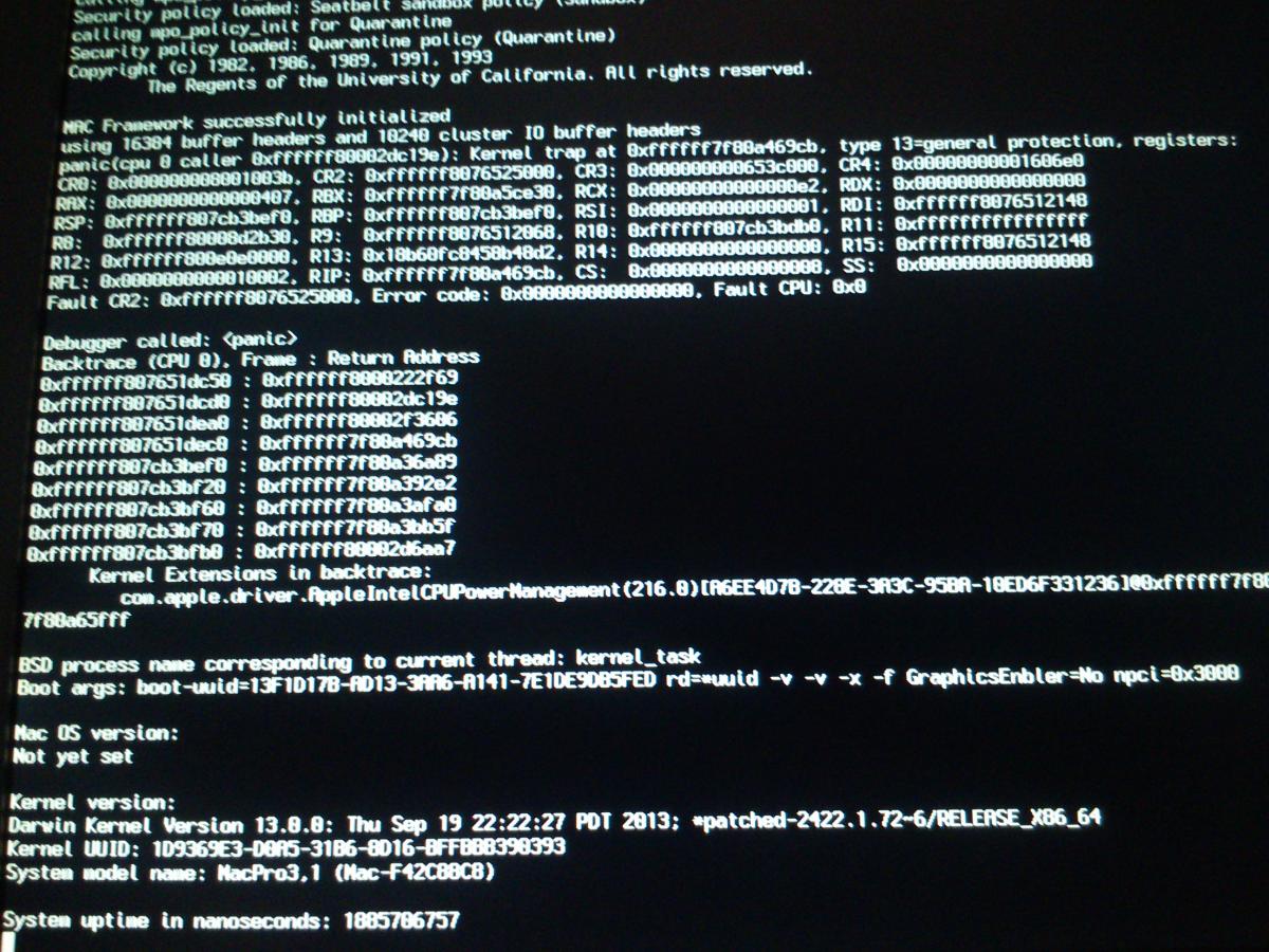

carbo178 Posted October 15, 2013 Share Posted October 15, 2013 E' un Kernel Panic; avvia con -v e fai una foto al Panic 1 Link to comment Share on other sites More sharing options...
Biagio Posted October 15, 2013 Author Share Posted October 15, 2013 fatta come posso upparla? Link to comment Share on other sites More sharing options...
carbo178 Posted October 15, 2013 Share Posted October 15, 2013 More Reply Options poi Sfoglia su Attach files Link to comment Share on other sites More sharing options...
Biagio Posted October 15, 2013 Author Share Posted October 15, 2013 ecco ecco Link to comment Share on other sites More sharing options...
carbo178 Posted October 15, 2013 Share Posted October 15, 2013 Manca NullCPUPowerManagement.kext; vai nella chiavetta in Sistema/Libreria/Extensions (S/L/E), copia NullCPU e FakeSMC in Extra/Extensions della chiavetta (se non c'è la cartella Extensions in Extra creala). Riavvia da USB con -v -f scegliendo il sistema installato, quando sei dentro inserisci i 2 kext in S/L/E dell'hard disk con kext utility o kext wizard Al successivo riavvio dovrebbe andare tutto bene, ma per precauzione avvia con -v; se si blocca fai una foto e postala Link to comment Share on other sites More sharing options...

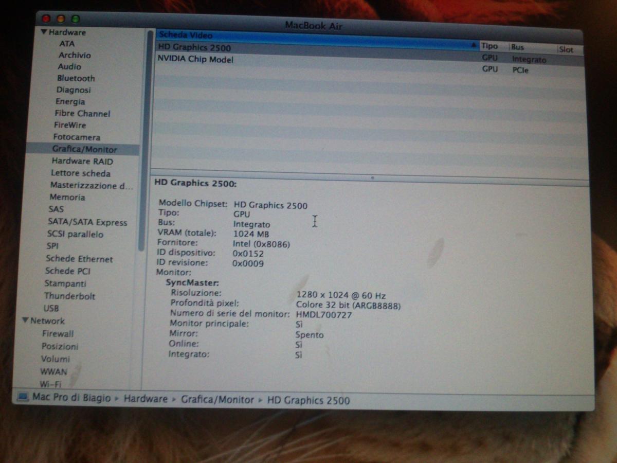

Biagio Posted October 15, 2013 Author Share Posted October 15, 2013 Grazie funziona ma adesso ho problemi con kext non riesco ad abilitare l'audio alc662 ethernet e Intel HD 2500 Riconosciuta ma non ho i qe/ci Link to comment Share on other sites More sharing options...
carbo178 Posted October 16, 2013 Share Posted October 16, 2013 Proviamo ad abilitare la video... avvia con GraphicsEnabler=Yes SkipNvidiaGFX=Yes Per l'audio sezione Downloads-kext-Audio trovi ALC662 1 Link to comment Share on other sites More sharing options...

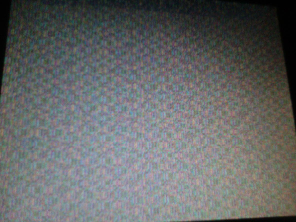

Biagio Posted October 16, 2013 Author Share Posted October 16, 2013 Ieri ho provato ad abilitarla con efi riconosciuta come hd 4000 ma arrivo al desktop tutto sfarfallato con -x Si avvia posso cambiare risoluzione appena lo faccio sfarfalla di nuovo o fatto un casino Link to comment Share on other sites More sharing options...
carbo178 Posted October 16, 2013 Share Posted October 16, 2013 Togli la EFI string e prova le due flag al boot Link to comment Share on other sites More sharing options...

Biagio Posted October 16, 2013 Author Share Posted October 16, 2013 Fatto sempre lo stesso problema artefatti nemmeno posso fare il login invece o provato con efi string e mi carica al infinito Link to comment Share on other sites More sharing options...

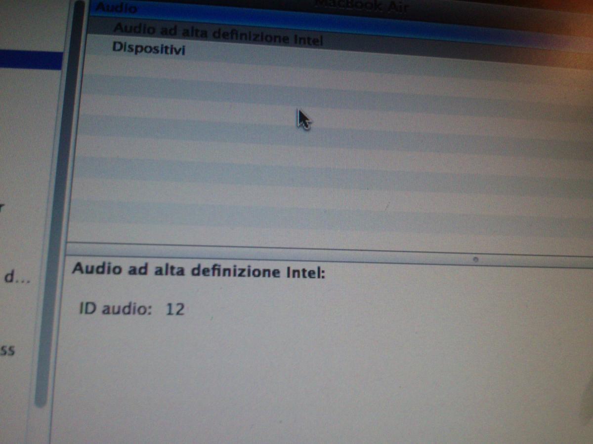

Biagio Posted October 17, 2013 Author Share Posted October 17, 2013 il kext audio non funziona ora se riesco provo a patchare applehda con questo che mi a dato windows in id hardware HDAUDIO\FUNC_01&VEN_10EC&DEV_0662&SUBSYS_103C2AFB&REV_1003 Link to comment Share on other sites More sharing options...

carbo178 Posted October 17, 2013 Share Posted October 17, 2013 La "fregatura" è la HD2500, non so se con l'ultimo Enoch sia possibile avere tutto funzionante... puoi connettere il monitor alla nVidia e avviare con GraphicsEnabler=No Link to comment Share on other sites More sharing options...

Biagio Posted October 17, 2013 Author Share Posted October 17, 2013 comunque mi puoi spiegare come patchare il kext appleHDA cosi almeno posso sentirmi l'audio e il kext per ethernet cosi almeno mi aiuti un po che ogni volta non devo riavviare per fare le ricerche Link to comment Share on other sites More sharing options...
Biagio Posted October 18, 2013 Author Share Posted October 18, 2013 Questo partendo con -x Ge=yes con efi del hd 4000 e Mac mini 6.2 hd 2500 settata a 64 mb perché non ce la voce sul BIOS x impostarla a 32 osx 10.9 gm Eccolo Questo in audio Link to comment Share on other sites More sharing options...
