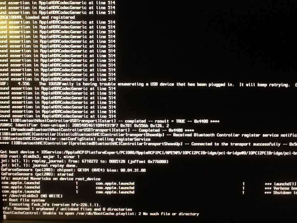

zecco Posted October 28, 2013 Author Share Posted October 28, 2013 Oltre alle opzioni di default (Enoch Bootloader - HDAEnabler - GraphicsEnabler - Verbose Mode) ho flaggato questi kext: AD2000B RTC patch LegacyAppleYukon2.kext AHCIPortInjector.kext IOAHCIBlockStorageInjector.kext Nec/Renesas FakeSMC Plug-in (tutti) E questo é il risultato Link to comment https://www.insanelymac.com/forum/topic/292665-preparazione-installazione-maverick/page/2/#findComment-1960049 Share on other sites More sharing options...

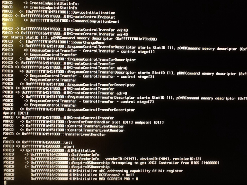

Fabio1971 Posted October 29, 2013 Share Posted October 29, 2013 Ok, per la USB 3 il chip e' della Nec per il kext prova : http://www.insanelymac.com/forum/topic/286860-genericusbxhci-usb-30-driver-for-os-x-with-source/ Domando funziona bene come controller Fabio Link to comment https://www.insanelymac.com/forum/topic/292665-preparazione-installazione-maverick/page/2/#findComment-1960316 Share on other sites More sharing options...

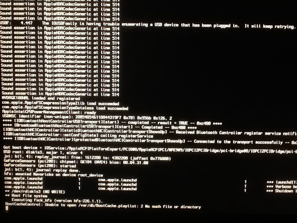

zecco Posted October 29, 2013 Author Share Posted October 29, 2013 Figurati Fabio. Grazie a te per i tuoi consigli e la tua pazienza altroché... Purtroppo le cose non migliorano. Ho reinstallato Mav senza il kext per le USB 3.0 ottenendo questo: Link to comment https://www.insanelymac.com/forum/topic/292665-preparazione-installazione-maverick/page/2/#findComment-1960559 Share on other sites More sharing options...
Fabio1971 Posted October 29, 2013 Share Posted October 29, 2013 Una prova al boot parti con : -v npci=0x2000 GraphicsEnabler=No Fabio Link to comment https://www.insanelymac.com/forum/topic/292665-preparazione-installazione-maverick/page/2/#findComment-1960581 Share on other sites More sharing options...

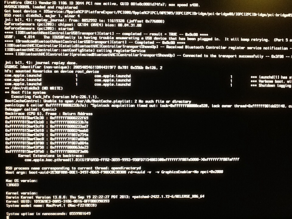

zecco Posted October 29, 2013 Author Share Posted October 29, 2013 Link to comment https://www.insanelymac.com/forum/topic/292665-preparazione-installazione-maverick/page/2/#findComment-1960588 Share on other sites More sharing options...
Fabio1971 Posted October 29, 2013 Share Posted October 29, 2013 Stranissimo possiamo vedere tante cose il bios hai queste impostazioni Main - Storage Configuration - Configure SATA [AHCI] Advanced - CPU coonfiguration - Intel HT Technology [Enabled] - Active Processor Cores [All] - A20M [Enabled] - tutto il resto [Enabled] - Onboard Devices Configuration - High Definition Audio [Enabled] - Marvell Storage Controller [Enabled] - Onboard 1394 Controller [Enabled] - USB Configuration -USB Function [Enabled] - USB 2.0 Controller [Enabled] - USB Controller Mode [HiSpeed] - EHCI Hand-OFF [Enabled] - Legacy USB Support [AUTO] Power - Suspend Mode [Auto] - Repost Video on S3 Resume [Yes] - ACPI 2.0 Support [Enabled] - ACPI APIC Support [Enabled] Boot - Boot Device Priority - 1st Boot Device [hard disk] - 2nd Boot Device [DVD] - 3rd Boot Device [Disabled] Fabio 1 Link to comment https://www.insanelymac.com/forum/topic/292665-preparazione-installazione-maverick/page/2/#findComment-1960612 Share on other sites More sharing options...

zecco Posted October 30, 2013 Author Share Posted October 30, 2013 Nulla da fare. Ho controllato le impostazioni di boot e sono come quelle che mi hai suggerito. Ho rifatto Pandora con esito positivo. Ho riformattato la partizione del SSD e reinstallato Mav con esito positivo. Ho inserito i kext del post #26 senza quelli per le USB 3.0. Questo è l'avvio con -v GraphicsEnabler=No npci=0x2000 Domanda: non é che cambiando le impostazioni con cui faccio Pandora riesco ad installare e usare Mav. Io ho fatto Opzione 2 Mac 4.1 Ho inserito il dsdt.aml che avevo con ML queste configurazioni dello script: NullCPUPowerManagement.kext+WiFiInjector.kext+AHCIPortInjecto.kext+IOAHCIBLockStorageInjector.kext Link to comment https://www.insanelymac.com/forum/topic/292665-preparazione-installazione-maverick/page/2/#findComment-1961042 Share on other sites More sharing options...
Fabio1971 Posted October 30, 2013 Share Posted October 30, 2013 La configurazione dello scrript è sbagliata devi usare questa : Il NullCPUPowerManagement.kext devi eliminarlo Fabio 1 Link to comment https://www.insanelymac.com/forum/topic/292665-preparazione-installazione-maverick/page/2/#findComment-1961051 Share on other sites More sharing options...

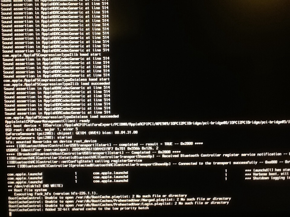

zecco Posted October 30, 2013 Author Share Posted October 30, 2013 Scusami Fabio ho sbagliato a scrivere. Avevo fatto quella scelta. Ad ogni modo ho rifatto Pandora e reinstallato tutto per l'ottava volta ma evidentemente c'è qualcosa che sbaglio o nel processo di creazione di Pandora o nel processo di installazione di Mav. L'unica cosa certa é che lo installa ma per il resto si ferma lì perché poi non riesco ad ottimizzarlo e ad usarlo. Provato anche ad inserire l'AppleACPIPlatform.kext ma sempre con questo risultato: Link to comment https://www.insanelymac.com/forum/topic/292665-preparazione-installazione-maverick/page/2/#findComment-1961122 Share on other sites More sharing options...

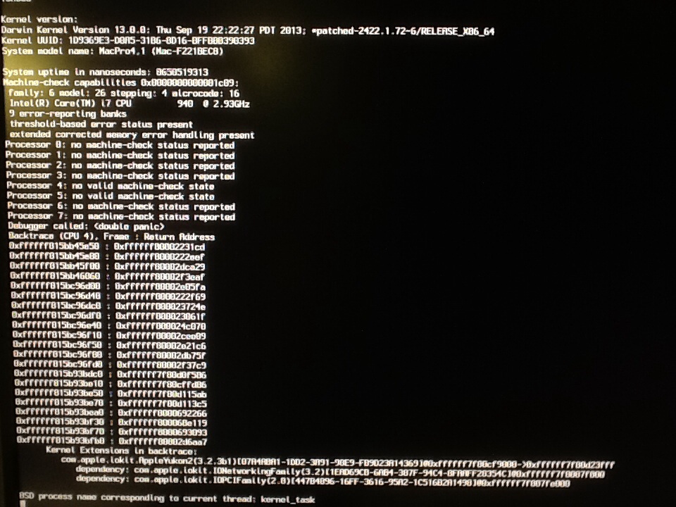

zecco Posted October 31, 2013 Author Share Posted October 31, 2013 Confermo E l'ethernet che manda in KP il sistema. Qualsiasi kext io utilizzi ho sempre KP. Provato con LegacyAppleYukon2.kext IONetworkingFamily.kext Marvel88E8056.kext Cosa fare? Link to comment https://www.insanelymac.com/forum/topic/292665-preparazione-installazione-maverick/page/2/#findComment-1961782 Share on other sites More sharing options...
Fabio1971 Posted November 1, 2013 Share Posted November 1, 2013 Fai questa prova allora nell'installazione - Personalizza flagga solo il kext FakeSMC e il bootloader almeno vediamo se arrivi al desktop Fabio Link to comment https://www.insanelymac.com/forum/topic/292665-preparazione-installazione-maverick/page/2/#findComment-1961877 Share on other sites More sharing options...
