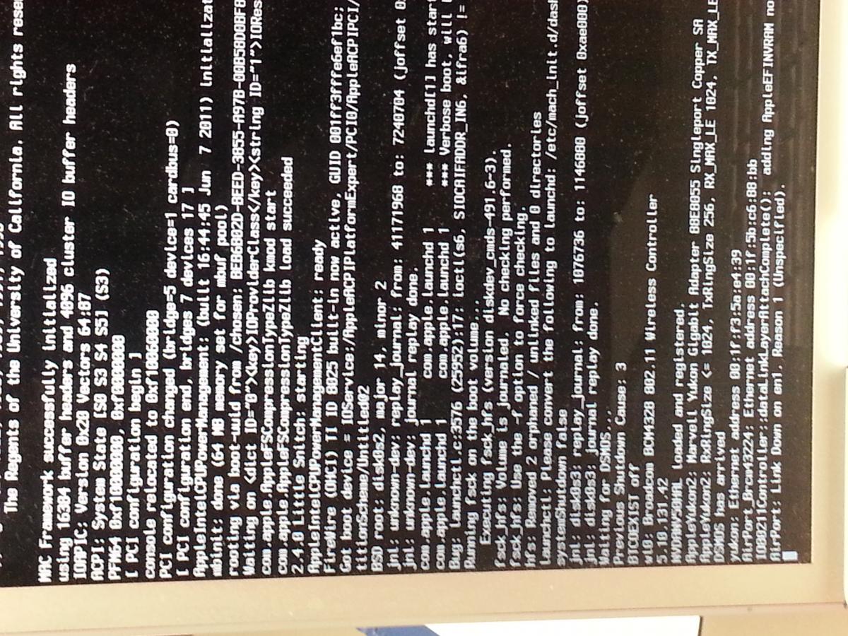

notechy Posted October 9, 2013 Share Posted October 9, 2013 Hi All My MBP(early 2008) has stopped working. As said above it starts ok after pressing start with led light on. Soon after, the light stops and loading continues for a little time till the spinning wheel stops and that is the end. Have tried safe boot, pram, and also started with the initial os x dvd without any success. I have taken out the HDD(the replacement hdd) and tested it with my friends MBP and drive is fine.Have now inserted the original HDD and still the same. Attached is the starting screen. Is anyone of you able to give me a hint? Thanks Link to comment https://www.insanelymac.com/forum/topic/292573-mbp-start-ok-light-goes-offf-and-then-stop/ Share on other sites More sharing options...

dcai777 Posted October 10, 2013 Share Posted October 10, 2013 can you safeboot? and the screenshot doesn't actually show any problems... Link to comment https://www.insanelymac.com/forum/topic/292573-mbp-start-ok-light-goes-offf-and-then-stop/#findComment-1952977 Share on other sites More sharing options...
notechy Posted October 10, 2013 Author Share Posted October 10, 2013 can you safeboot? and the screenshot doesn't actually show any problems... No, safe boot stops also some way along before the desktop. One thing I haven't mentioned is how it started. After a work break I came back and the screen had gone dark(not black) and could still see the screen saver image flickering. I was not able to get any reaction with any keys so I forced a manual shutdown with the power button. No joy since..... Link to comment https://www.insanelymac.com/forum/topic/292573-mbp-start-ok-light-goes-offf-and-then-stop/#findComment-1952980 Share on other sites More sharing options...
