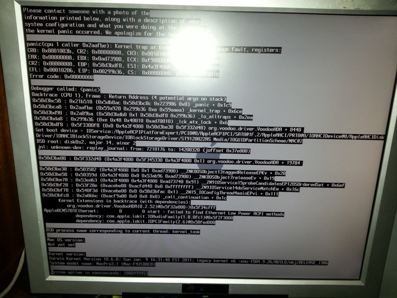

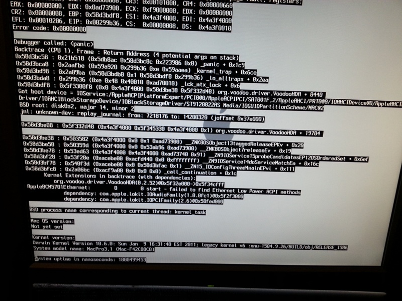

riot159 Posted October 7, 2013 Share Posted October 7, 2013 Hi everybody,john here. i was so close to get a clean istallation on my laptop Acer aspire 5738zg [intel Core Duo 2.2 Ghz, 4gb ram, Ati Radeon HD 4650). I need your help pls. I istalled with hazard 10.6.6 SL and after so many times it working fine. the only problem was that to work i must use the -v mode to get the os working. So i started to install kext with kext helper, and after all i run [url="http://www.insanelymac.com/forum/topic/279450-why-insanelymac-does-not-support-tonymacx86/"]#####[/url] for SL checking [url="http://www.insanelymac.com/forum/topic/279450-why-insanelymac-does-not-support-tonymacx86/"]#####[/url], the new bootloader (boot no more from dvd) i also downloadedand installed a kext for my video card. after thoose installations i reparied permission but once reboot the system, it didnt work any more(struck at apple logo or restart); even with -v mode( i tried -x,-f , graphics enabler no and so on). this is a screen i took with my phone when i used -f mode. Can someone explain me what goes wrong and pls say me how i can repair it (i'm low level mac user and ultra beginner of hackintosh) Thanks to all Link to comment https://www.insanelymac.com/forum/topic/292504-i-was-so-close/ Share on other sites More sharing options...
StoneTemplePilots Posted October 7, 2013 Share Posted October 7, 2013 Hi everybody,john here. i was so close to get a clean istallation on my laptop Acer aspire 5738zg [intel Core Duo 2.2 Ghz, 4gb ram, Ati Radeon HD 4650). I need your help pls. I istalled with hazard 10.6.6 SL and after so many times it working fine. the only problem was that to work i must use the -v mode to get the os working. So i started to install kext with kext helper, and after all i run ##### for SL checking #####, the new bootloader (boot no more from dvd) i also downloadedand installed a kext for my video card. after thoose installations i reparied permission but once reboot the system, it didnt work any more(struck at apple logo or restart); even with -v mode( i tried -x,-f , graphics enabler no and so on). this is a screen i took with my phone when i used -f mode. Can someone explain me what goes wrong and pls say me how i can repair it (i'm low level mac user and ultra beginner of hackintosh) Thanks to all As we can see VoodooHDA with IOPCIFamily.kext is causing trouble. But up from DVD/USB again and remove the Voodoo kext. There are patched IOPCIFamiliy.kexts for mobile devices which can be found on the web, for example here or here. Did you create a patched DSDT? Are you sure the Broadcom kext is fine or is it genuine? Link to comment https://www.insanelymac.com/forum/topic/292504-i-was-so-close/#findComment-1951998 Share on other sites More sharing options...
riot159 Posted October 8, 2013 Author Share Posted October 8, 2013 As we can see VoodooHDA with IOPCIFamily.kext is causing trouble. But up from DVD/USB again and remove the Voodoo kext. There are patched IOPCIFamiliy.kexts for mobile devices which can be found on the web, for example here or here. Did you create a patched DSDT? Are you sure the Broadcom kext is fine or is it genuine? Hi , ty for reply. I dont know how i can remove the kext, can you explain it? I remembered i need single user mode, but when i boot in that mode nothing happens. just white lines written on black screen but i cant write nothing. After my first installation, before i applied multibeas-t , lan worked fine, wifi also worked fine. Audio worked fine too , but volume level was low (even with all 100%). Sorry i'm newbe what is PAtched dstd? where i can find and how can I istall it?. Really thank you for this, long time i tried to switch my Laptop in an Hacktop EDIT: I formatted and tried again the procedure. I installed hzrd 10.6.6i . I checked LEgacy kernel, voodoo battery, keyboard/trakpad controller HDAvoodoo 2.7.? . I founded also DSTD patch and i check it. ofc i cheked Cham 2.0 rc5. Now, OSX work only with verbose mode. with normal or -x it stops to apple logo (without loading circle). What should i do to get a normal start up? Link to comment https://www.insanelymac.com/forum/topic/292504-i-was-so-close/#findComment-1952137 Share on other sites More sharing options...
Onixs Posted October 8, 2013 Share Posted October 8, 2013 All you have to do is to remove applehda.kext from S/L/E based on the picture you posted above. This is because voodoohda conflicts with applehda. Now its your turn to google a bit on how to remove kexts and repair permission/clear cache. Link to comment https://www.insanelymac.com/forum/topic/292504-i-was-so-close/#findComment-1952189 Share on other sites More sharing options...
