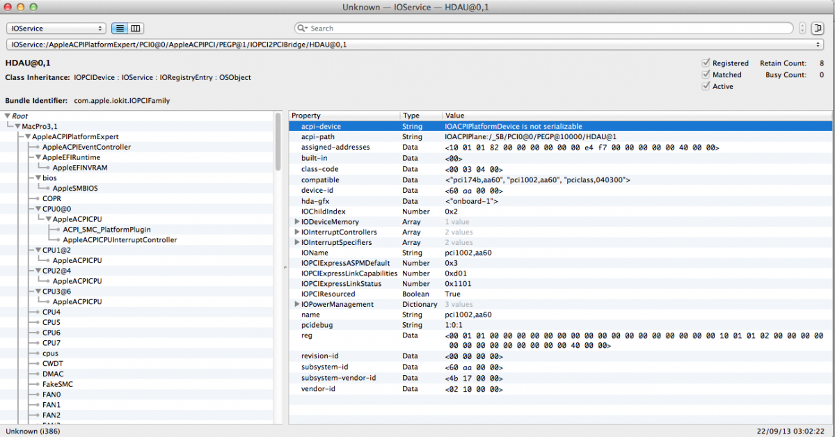

Marco macuser Posted September 22, 2013 Share Posted September 22, 2013 I'm unable to make any audio device to work on my Hackintosh 10.8.3 (Intel DB75en with onboard ALC692 + ATI HD5670 no hdmi audio device listed OS is running fast with patched 10.8.3 AppleIntelCPUPowerManagement.kext and Chamaleon boot loader (speedstep, sleep is working) I tried to edit DSDT for HDMI audio in different ways, no luck, also tried with UEFI Guite. I attach my DSDT and IOReg output (with audio hdmi quick screenshot) Plaase I need help DSDT.aml.zip ioreg.zip Link to comment https://www.insanelymac.com/forum/topic/292060-ati-5670-hdmi-audio-dsdt-edit-or-onboard-audio-help/ Share on other sites More sharing options...
toleda Posted September 22, 2013 Share Posted September 22, 2013 I'm unable to make any audio device to work on my Hackintosh 10.8.3 (Intel DB75en with onboard ALC692 + ATI HD5670 no hdmi audio device listed This is a big challenge. AppleHDA.kext is not loading. Is the installed AppleHDA.kext edited for 692 audio? Has it ever worked? Regarding HDMI audio, The edits appear correct. However, IOReg says there is not an HDMI device connected, correct? Link to comment https://www.insanelymac.com/forum/topic/292060-ati-5670-hdmi-audio-dsdt-edit-or-onboard-audio-help/#findComment-1947659 Share on other sites More sharing options...
Marco macuser Posted September 22, 2013 Author Share Posted September 22, 2013 This is a big challenge. AppleHDA.kext is not loading. Is the installed AppleHDA.kext edited for 692 audio? Has it ever worked? Regarding HDMI audio, The edits appear correct. However, IOReg says there is not an HDMI device connected, correct? Thank you for your reply, I was using your mod so it's an honour for me to speak with you. HDMI is correctly connected to ATI 5670 (display port to Monitor, HDMI to ToshibaTV, in windows HDMI works) I even tried SDST-1.aml solution. For AppleHDA.kext I did not find anything (only ALC662). For DSDT I created myself with DPCIManager, only patch used is for HDMI and I'm using modded AppleIntelCPUPowerManagement.kext and graphicsenabler=yes Do I need any other patch to DSDT ? System founds 2 Audio Devices with DPCIManager, used to save video bios: http://62.212.75.48/uploads/1002_68d8_e152174b.zip Thank you Link to comment https://www.insanelymac.com/forum/topic/292060-ati-5670-hdmi-audio-dsdt-edit-or-onboard-audio-help/#findComment-1947704 Share on other sites More sharing options...

k3nny Posted September 22, 2013 Share Posted September 22, 2013 @Marco macuser: Your board's specifications state that you have an ALC662 chip. The DSDT you uploaded has 4 "onboard-1" properties. You should leave "onboard-1" for HDEF&IGPU and change the other two to "onboard-2" for GFX0&HDAU. Link to comment https://www.insanelymac.com/forum/topic/292060-ati-5670-hdmi-audio-dsdt-edit-or-onboard-audio-help/#findComment-1947782 Share on other sites More sharing options...
