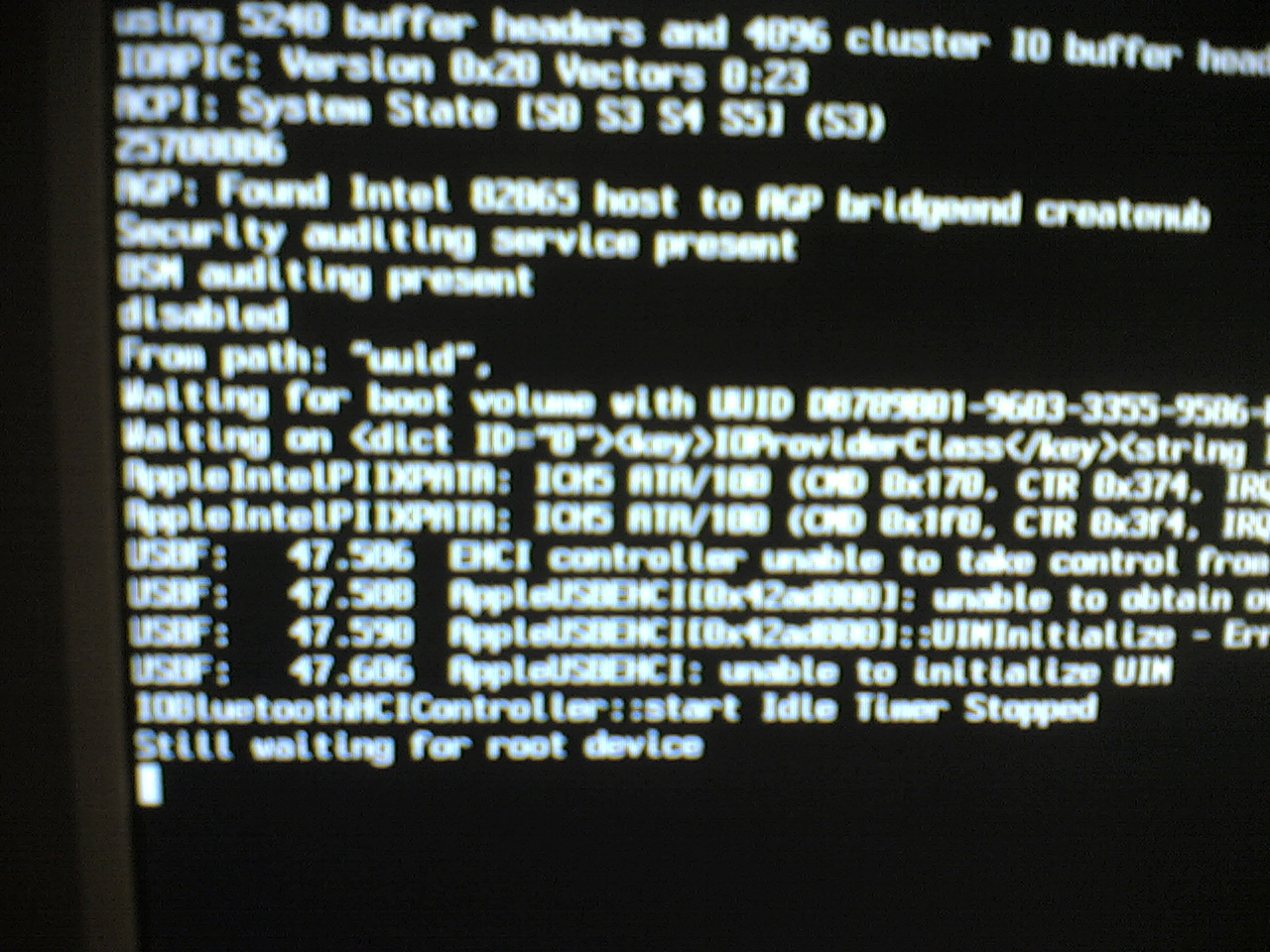

BuXb Posted October 3, 2006 Share Posted October 3, 2006 - please make a photo of the entire lower portion (also the part on the right) - please make it clearer so it is readable - please make it smaller in pixel size so it fits the screen without having to be resized - resizing makes the photo worse to read Link to comment Share on other sites More sharing options...
alexp Posted October 3, 2006 Author Share Posted October 3, 2006 ok, this is better: Link to comment Share on other sites More sharing options...
BuXb Posted October 3, 2006 Share Posted October 3, 2006 Looking at the boot screen I would approach this from a different angle since you know that you do have a bootable system: I see you are also booting WinXP on your system, so you have access to the WinXP Bootloader. Here's what to do: - in BIOS set back to boot from IDE - boot Windows XP - edit the file boot.ini on the root level of your HD (it is hidden so you must allow "show hidden files" in Windows). Under the line where it says something like "multi(0)disk(0)rdisk(0)partition(1)\WINDOWS="......" add a line C:\chain0="Mac OS x86" - copy the file chain0 (download from here) to the root level of you internal HD (same level as the boot.ini) - make sure "showing boot loader for xx seconds" is enabled in Windows and reboot The Windows Bootloader should now have come up. - pick "Mac OS x86" by scrolling down to it, hit Enter _The darwin bootloader should have found your install on USB and display it's name - if the Mac OS x86 partition on your external HS is not set to active you need to scroll down to the name of your Mac OS install and hit enter. If you have set no delay in the darwin bootfile (which is not advantageous) your Mac OS will have started by now anyway, and will hopefully boot through all the way If you do not have another install on your internal HD (only the one on an external via USB) this is the way to go. With two inistalls, one on internal and one on external, Mac OS won't boot correctly from external but switch to booting the internal system at the beginning of the boot process. Good luck. Link to comment Share on other sites More sharing options...
