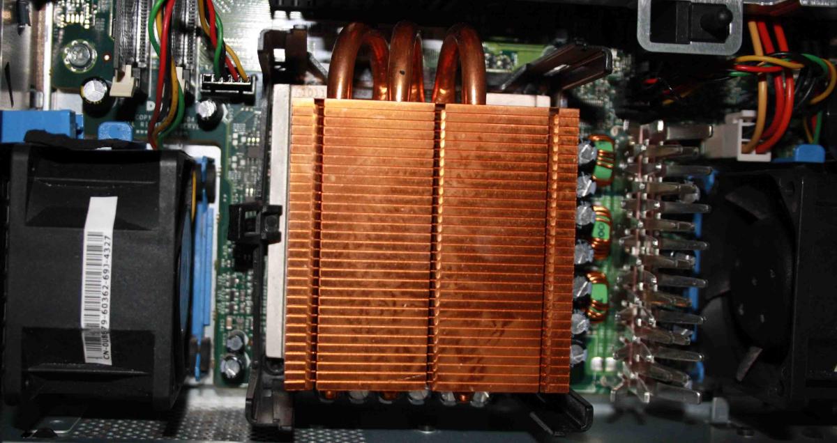

Cerastez Posted September 14, 2013 Share Posted September 14, 2013 The USFF GX280 that I have did come with a copper heatsink and I did re-use it. From your description of copper tubes, I would say that you have the heatsink that will work. And I think that you are right, the fan that comes with the processor you bought won't be something that can be installed. This is the Dell manual, page 212 has instructions on replacing the processor. Link to comment Share on other sites More sharing options...
roses Posted September 15, 2013 Author Share Posted September 15, 2013 The USFF GX280 that I have did come with a copper heatsink and I did re-use it. From your description of copper tubes, I would say that you have the heatsink that will work. And I think that you are right, the fan that comes with the processor you bought won't be something that can be installed. That is good news. Have taken a pic and will try to upload it. How feasible is it to move the insides of a USFF to another case, eg ATX? Success!! This is the Dell manual, page 212 has instructions on replacing the processor. D'oh!!! Now I'm the stupid one and I'm telling myself: RTFF One of the first things I did actually was to download the manual and wondered why it was so huge until I realised it covered all four case sizes. I did flick through it (not easy on a PDF, much prefer a paper version) but only in order to find specific answers to a few questions (eg 1) When I was trying to sort out the 'no internet' issue exactly what the colours of the LED next to the RJ45 ethernet socket mean; and 2) how to activate the USB ports on the side of the monitor. I still don't know. Do you?). But never in my wildest dreams would I have thought it would show you how to change the processor. That's fairly unusual wouldn't you agree? Especially for a company like Dell who market their PCs at shall we say the less geeky end of the population. ("I own a car and know where to put the gas in but other than that I don't know and have no desire to know how it works!!") Link to comment Share on other sites More sharing options...
Cerastez Posted September 15, 2013 Share Posted September 15, 2013 After looking at the picture, I have no doubt that you have the right heat sink. I have never tried to move the guts of a computer into another case, so I'm not sure how that would work out. The only real issue that I can see is overheating. As long as there is airflow into and out of those black plastic shrouds, I would think it would be okay. I have gotten to be a big fan of Dell. Their manuals are generally very good but more than that, Dells just seem made for hackintoshing. I once hackintoshed two computers that both had the same motherboard, one was a Dell and one was an HP. The Dell was a piece of cake, but the HP was so difficult. I had to try installing a couple of times before it stuck and then everything was buggy and weird. HP's are awful to hackintosh. There was a rumor way back when that Dell was going to start selling computers with the Apple OS preinstalled. It never happened of course, but I do sometimes wonder if Dell doesn't design their computers so that they can take the Apple OS. Link to comment Share on other sites More sharing options...
