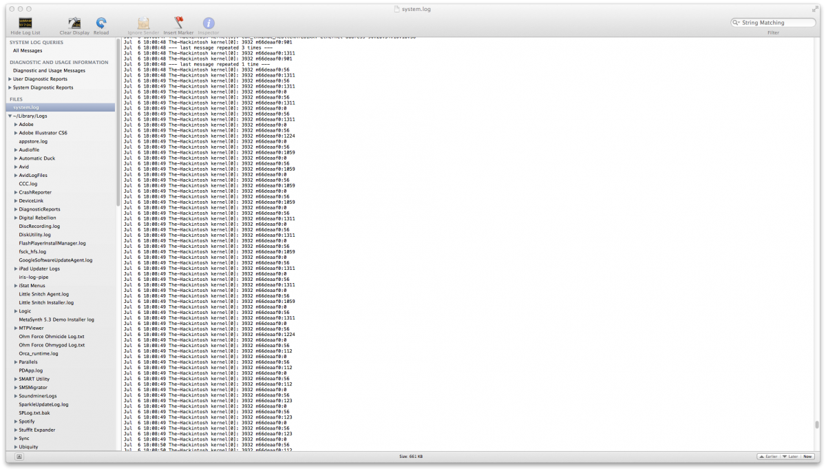

jamiethemorris Posted July 7, 2013 Share Posted July 7, 2013 I noticed my boot time is a lot slower lately. I have 10.8.3 with a fusion drive setup and it used to boot so fast that the apple logo wouldn't even get to make a complete circle. Now it spins probably 6 or 7 times. I haven't actually used a stopwatch to see how long it's takin. I'm not sure what caused it, so I decided to check the system.log. I'm getting a bunch of repeated messages that say 3932 m66deaaf0: and then a number. I googled it and I can't find anything on what these mean. I'm pretty sure this is the cause of why it's taking so long. I have attached a screenshot of the messages, but they go on for much longer than you can see in the picture. Link to comment https://www.insanelymac.com/forum/topic/290394-weird-messages-in-systemlog-at-boot-time/ Share on other sites More sharing options...
beatlejuice Posted July 27, 2013 Share Posted July 27, 2013 I recently ran into the same problem with the "3932 m66xxxx" error and could only boot my system to safe mode. No problems duel booting into Win 7 Ultimate. Ran every utility i could think. Needless to say that I spent many days trying to solve this. If you are using org.chameleon.Boot.plist my suggestion is to add <key>GraphicsEnabler</key> <string>Yes/string> I used to use the string "No" in order to do a clean boot and not have to unplug my HDMI and replug the HDMI using on board Intel HD 4000. This function must have been in recent changes to [url="http://www.insanelymac.com/forum/topic/279450-why-insanelymac-does-not-support-tonymacx86/"]#####[/url] or Chimera. Here is my full org.chameleon.Boot.plist /Extra/org.chameleon.Boot.plist <!DOCTYPE plist PUBLIC "-//Apple//DTD PLIST 1.0//EN" "http://www.apple.com/DTDs/PropertyList-1.0.dtd"> <plist version="1.0"> <dict> <key>EthernetBuiltIn</key> <string>Yes</string> <key>GenerateCStates</key> <string>Yes</string> <key>GeneratePStates</key> <string>Yes</string> <key>GraphicsEnabler</key> <string>Yes/string> <key>Kernel</key> <string>mach_kernel</string> <key>Kernel Flags</key> <string>darkwake=0</string> <key>Legacy Logo</key> <string>Yes</string> <key>Timeout</key> <string>2</string> <key>UseKernelCache</key> <string>Yes</string> <key>Graphics Mode</key> <string>"1920x1080x32"</string> </dict> </plist> Please let me know if this was of any help. OSX 10.8.3/4 GA-z77x-UD5H SANDISK Extreme SSD120 32gb Corsair Vengeance ram, i7 3770k 3.7 Ghz Intel HD 4000 via HDMI Tonymacx86 [url="http://www.insanelymac.com/forum/topic/279450-why-insanelymac-does-not-support-tonymacx86/"]#####[/url] 5.4.1 Chimera 2.1.1 Link to comment https://www.insanelymac.com/forum/topic/290394-weird-messages-in-systemlog-at-boot-time/#findComment-1934874 Share on other sites More sharing options...
