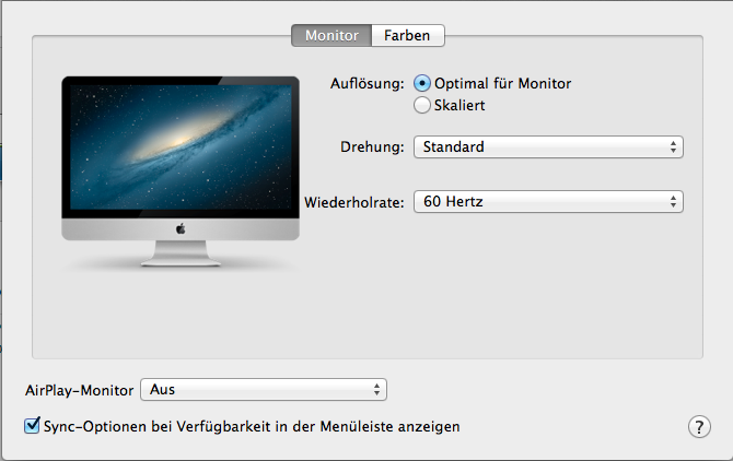

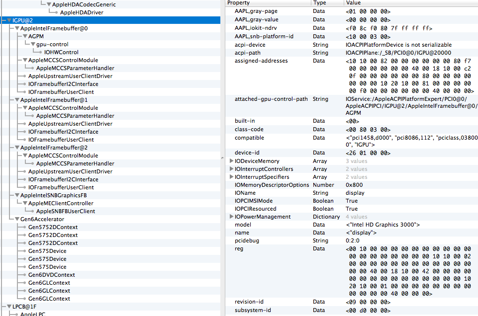

hi everybody, here is a DSDT code to Enabled HD 3000 on Z77 without kext edit. Works like a charm with Airplay, i Use it with a AMD 6870 works even without.
Device (MEI)
	                Name (_ADR, 0x00160000)  // _ADR: Address
	                Method (_DSM, 4, NotSerialized)  // _DSM: Device-Specific Method
	                    Store (Package (0x0C)
	                            "device-id",
	                            Buffer (0x02)
	                                 0x3A, 0x1C
	                            "IOName",
	                            Buffer (0x0D)
	                                "pci8086,1c3a"
	                            "name",
	                            Buffer (0x0D)
	                                "pci8086,1c3a"
	                            "revision-id",
	                            Buffer (0x04)
	                                 0x04, 0x00, 0x00, 0x00
	                            "subsystem-vendor-id",
	                            Buffer (0x04)
	                                 0x86, 0x80, 0x00, 0x00
	                            "vendor-id",
	                            Buffer (0x04)
	                        }, Local0)
	                    Return (Local0)
here is my DSDT For Z77-DS3H F10i
