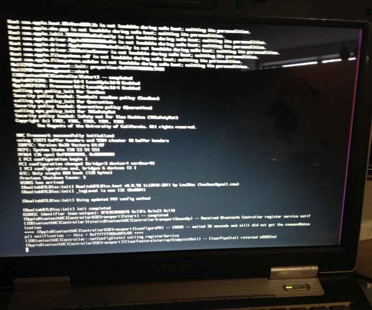

jommoner Posted June 2, 2013 Share Posted June 2, 2013 Hi all! I'm trying to install ML on my laptop - an Asus A8JR; it is getting stuck at : USBMSC Identifier (non-unique): BF830.................... Machine Specs ------------------ CPU : Core 2 Duo T7200 2.0GHz GPU : Geforce 9650M GT (1GB RAM) (upgraded from original ATI X2300 128MB (rebadged bottom end 1000 series card) USB 2.0 SATA : ICH7-M RAM : 4GB, Dual-Channel Mode - 3GB visible. Modifications --------------- 1. The GPU has been upgraded; I used a vBIOS from an Asus M50 BIOS file, modded that, and placed it as a PCI Option ROM in the BIOS file. I've used it for years (literally) and it works fine in windows, and all flavours of Linux (using Mint 15 / Ubuntu Raring at present). 2. The CPU has been upgraded from the old 533MHz FSB 1.6GHz Core 2; this upgrade also works fine, the Microcode is present in the BIOS, the VT-x features work fine (weren't present on the old one). The chipset is running at 667MHz but it is designed to do that. The RAM is also rated for 667FSB and tests fine. 3. The BIOS doesn't have any SATA mode operation, and the SATA controller is stuck in IDE mode. However I have modified (upgraded) the DSDT file and the controller now boots in AHCI mode - and I have used the DSDT file on Linux and it works fine. I am also using the DSDT file for my Mountain Lion installation attempts and the DSDT file is being loaded (it states this when beginning to boot). Attempts to install --------------------- I have tried myHack as well as [the installer from the guy whose name begins with t who rips off other people's work without credit]. I am using a genuine copy of ML purchased on the Mac App Store, and using my MacBook Pro to build the USB drive (it is a non-retina model but has the same specs as the top-spec Retina MBP). All attempts fail at 'USBMSC Identifier (non-unique): XXXXXXXX 0x1sfe 0x1e23 0x110'. I have tried with PCIRootUID=0, GraphicsEnabler=No, -v, -x, -f I have also tried removing all the NV Kexts (for what it is worth, I was getting bluetooth errors turning up over the minute after the 'USBMSC' line appears - showing the system hadn't actually frozen - these have gone by deleting the bluetooth kexts. I have also tried : GraphicsEnabler=No PCIRootUID=0 -x -v -f (all in one go) - no change. I would be really grateful for any advice on how to proceed from here! Thank you! Edit : Attached photo of crash (including bluetooth errors that show up after the USBMSC line), Can't attach my DSDT.dsl - mods - am I permitted to attach it as a Zip for review if requested? Thanks! Link to comment https://www.insanelymac.com/forum/topic/288869-installing-ml-on-an-asus-a8jr-installer-wont-boot-up/ Share on other sites More sharing options...

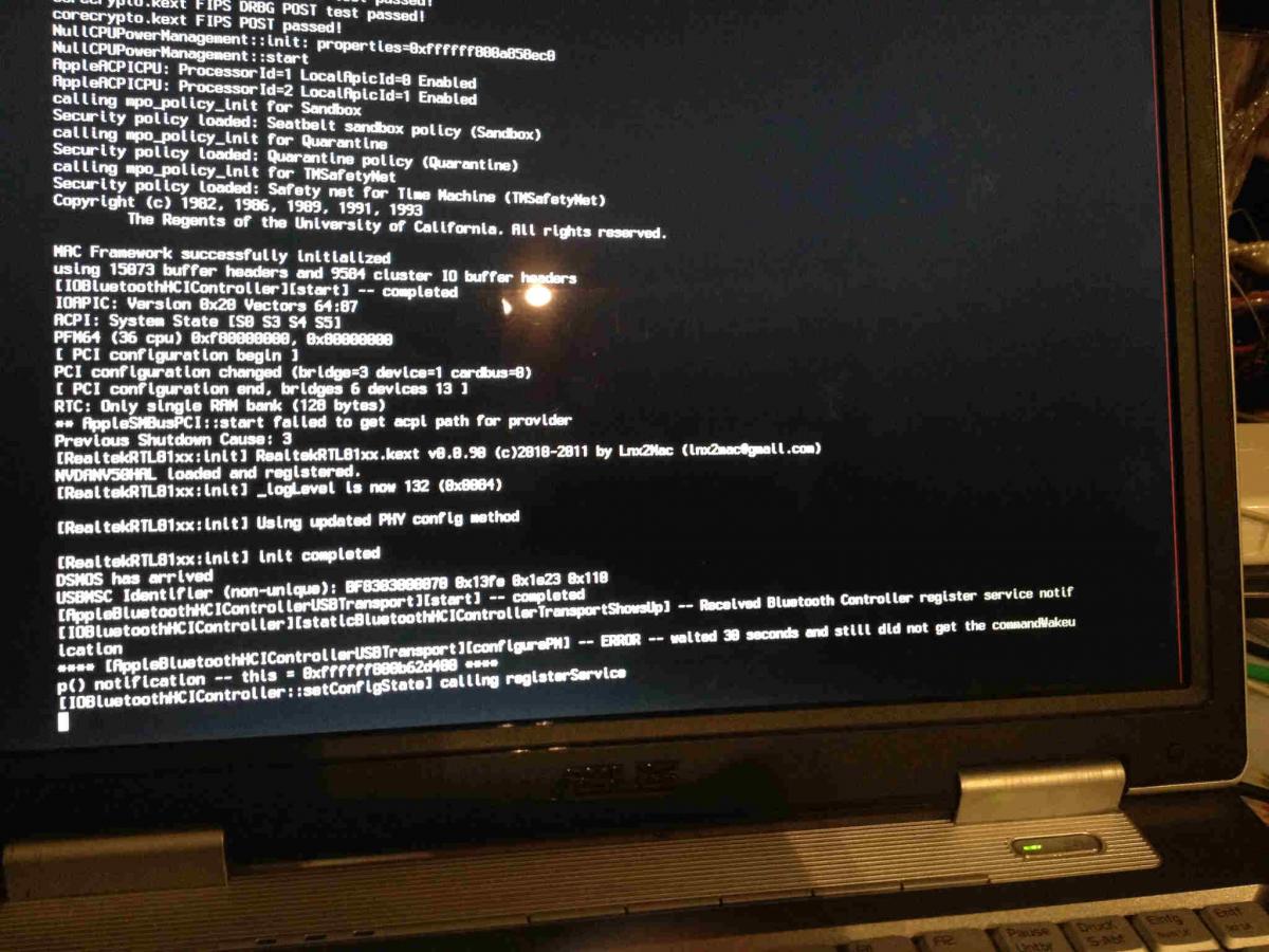

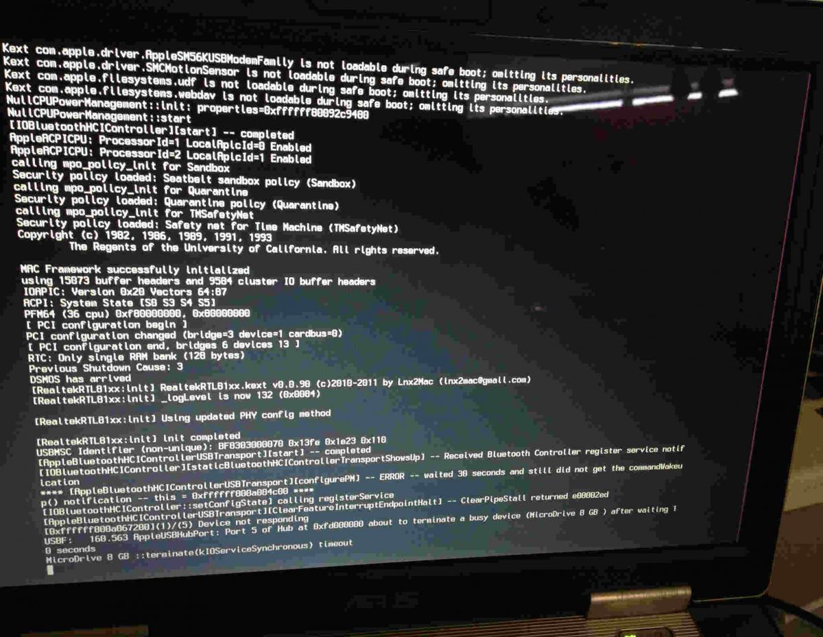

jommoner Posted June 3, 2013 Author Share Posted June 3, 2013 Hi! I removed all of those kexts from the Extensions folder (and added the Bluetooth back, but it makes no difference if the bluetooth is present or not). Not all of the kexts you listed were actually present but any that were, were removed. I used those boot parameters and a few other variants but all result in the installer hanging in the same place. The same thing happens - the first picture is taken a minute or two after the Bluetooth module does its thing; the second is taken about 4 minutes later when I removed the USB key I am installing from - so the messages are not relevant but do show the kernel hasn't 'locked up' or anything. I wish there was a way to get an even more verbose output - as when booting Linux - but I guess that isn't possible? I have attached the DSDT I am using as a 'zip' file - but it isn't a zip, just renamed to zip, so if it is renamed to .dsl or .txt then it should open in a text editor! Would be grateful for advice on what to try next! Thank you! DSDTdsl.zip Link to comment https://www.insanelymac.com/forum/topic/288869-installing-ml-on-an-asus-a8jr-installer-wont-boot-up/#findComment-1919440 Share on other sites More sharing options...
