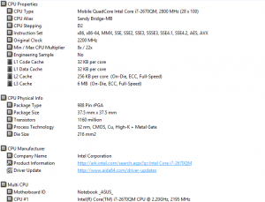

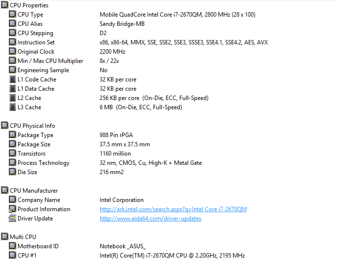

qwerty12 Posted May 16, 2013 Share Posted May 16, 2013 Hey, I also get x28 as the maximum with my 2670QM (patched BIOS, patched original DSDT [although PikeRAlpha's ssdtPRGen gives me 28 as max also]): This probably isn't an OS X problem, however; 2.80 GHz is what seems to be reported under Windows, too: This thread explains (I think) why. Link to comment https://www.insanelymac.com/forum/topic/288561-solved-speedstep-in-k53sc/#findComment-1915560 Share on other sites More sharing options...

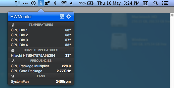

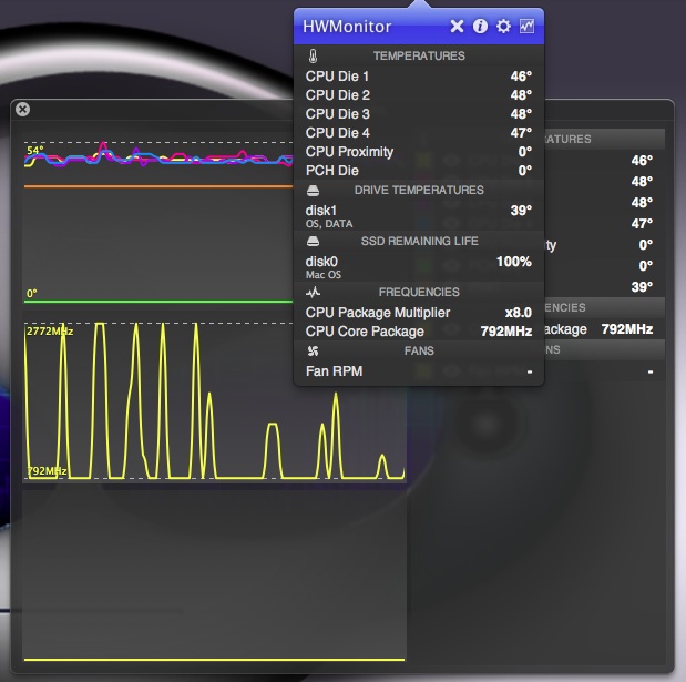

kali2000 Posted May 17, 2013 Author Share Posted May 17, 2013 Hi friend!!! thanx for your reply... This is my AppleIntelCPUPowerManagementInfo.kext test. Now I do not mind reading HWMonitor, I know it's erroneous. You can find AppleIntelCPUPowerManagementInfo.kext in the network and you can do same test in your machine and check if your SpeedStep are correct. Link to comment https://www.insanelymac.com/forum/topic/288561-solved-speedstep-in-k53sc/#findComment-1915765 Share on other sites More sharing options...
