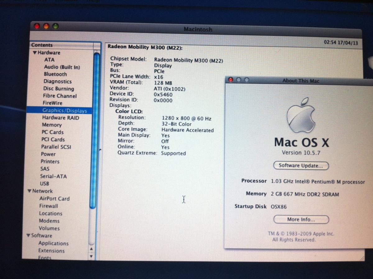

idanh Posted April 17, 2013 Share Posted April 17, 2013 My sister dropped me her old DELL Inspiron 6000 (2GB Ram and ATI Mobility X300) so I decided to give iAtkos v7 a try... I installed Audio and Wifi with no time, The ATI thingy was a real bitc... So I searched for a solution and found the X600 solution, changed the DevID, tried that and it didn't work. Then I discovered that they HEXed the ATI9700 file to fit the X600 - so I HEXed it myself to fit the X300... And it's good, well almost good... So now I have CI on Hardware and QE supported... Nothing is really working though, chess gives me a white screen and screen savers just gives me black screen. Could use some help here... If anyone knows what more can be done I uploaded a photo from my iPhone. Good night Link to comment https://www.insanelymac.com/forum/topic/287953-got-ati-mobility-x300-work-with-ci-and-qe-on-leopard/ Share on other sites More sharing options...
