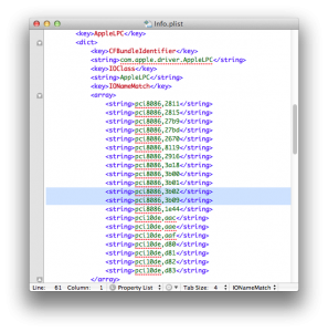

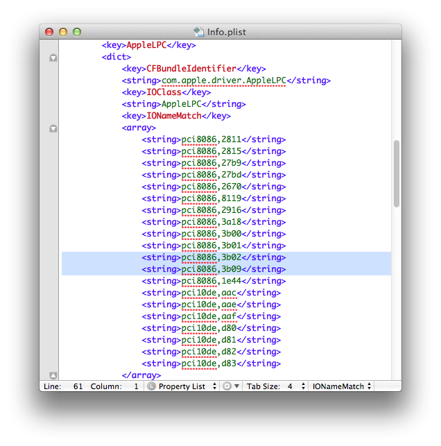

juanerson Posted April 1, 2013 Share Posted April 1, 2013 Hi. You should inject a LPC native ID (Mac OS X compatible) for Nehalem Notebook Core system, for example: "device-id", Buffer (0x04) { 0x09, 0x3B, 0x00, 0x00 /* or maybe 0x02, 0x3B */ } Of course, take it from /System/Library/Extensions/AppleLPC.kext/Info.plist More Patches: http://olarila.com/forum/patches.php And BTW, it is very recommended to use UseKernelCache=Yes from /Extra/o.c.B.p, or at least try it once from boot prompt. Good Luck. Link to comment https://www.insanelymac.com/forum/topic/287551-vpccw25fl/#findComment-1902630 Share on other sites More sharing options...
jl4c Posted April 2, 2013 Author Share Posted April 2, 2013 Thanks juanerson, i've solved my problem . Can you please check my other post? http://www.insanelymac.com/forum/topic/287591-hdmi-audio-gt-330m-ml-1083/ Link to comment https://www.insanelymac.com/forum/topic/287551-vpccw25fl/#findComment-1903202 Share on other sites More sharing options...
