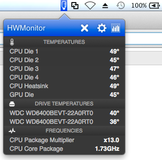

Alex009988 Posted March 22, 2013 Share Posted March 22, 2013 Hello I have a problems with editing DSDT for ACPISensors. I tried everything that I could. And now don't know what I should do next. Help me to cope with it, please. I have CPUSensors and GPUSensors at the moment. And I wish to HWmonitor would have showed voltage and fan's speed as well. DSDT.aml.zip Link to comment https://www.insanelymac.com/forum/topic/287287-help-me-with-editing-dsdt-for-acpisensors/ Share on other sites More sharing options...
Alex009988 Posted March 22, 2013 Author Share Posted March 22, 2013 I receive a little success. Device (SMCD) { Name (_HID, "MONITOR") Method (TCPU, 0, NotSerialized) { Store (^^EC.CTMP, Local0) Return (Local0) } } With this method I got CPUHeatsink. But I have no idea where is fan at my DSDT. Help me fellows, please! I know that I should add this method for fan Method (FAN0, 0, NotSerialized) { Store (\_SB.PCI0.LPC.EC.[size=5][b]What should be here in my case?[/b][/size], Local0) Return (Local0) } Ver0.1DSDT.aml.zip 1 Link to comment https://www.insanelymac.com/forum/topic/287287-help-me-with-editing-dsdt-for-acpisensors/#findComment-1899760 Share on other sites More sharing options...
