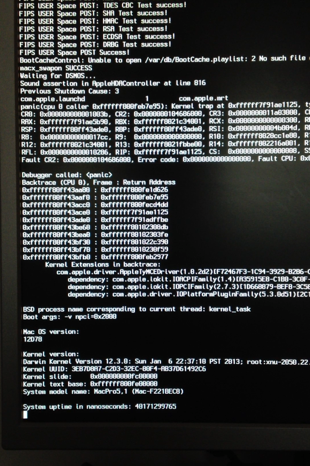

Ion Darie Posted March 16, 2013 Share Posted March 16, 2013 Hello guys, I managed to install a frech copy of ML 10.8.3 using the clover bootloader (it's the only one that allows me to install ML without taking the AMD 7770 out of my computer). The main problem i have is that i cant boot in normal mode whatever i do if i boot with -x all works well but in normal i get a crash see the attached picture. If anyone has any ideas please help! Link to comment https://www.insanelymac.com/forum/topic/287116-ml-1083-on-msi-zh77a-g43-msi-r7770/ Share on other sites More sharing options...
carbo178 Posted March 16, 2013 Share Posted March 16, 2013 Hi, remove AppleTyMCEDriver.kext from installation USB, or change smbios with iMac 13,1 Link to comment https://www.insanelymac.com/forum/topic/287116-ml-1083-on-msi-zh77a-g43-msi-r7770/#findComment-1897416 Share on other sites More sharing options...
buoo Posted March 16, 2013 Share Posted March 16, 2013 As carbo says delete the kext, here a mini how-to http://www.insanelymac.com/forum/topic/207456-kernel-panic-appletymcedriver/ Link to comment https://www.insanelymac.com/forum/topic/287116-ml-1083-on-msi-zh77a-g43-msi-r7770/#findComment-1897418 Share on other sites More sharing options...
Ion Darie Posted March 16, 2013 Author Share Posted March 16, 2013 ok guys, so i deleted the kext and booted using -v all goes well no errors but when it should show the login screen my monitor goes black... (i only see the grey screen for 1 second). The computer is still runing but the display is black update: i managed to fix the black screen issue afer messing around with graphics setting in clover bootloader. but now i am faced with a gray screen and it wont go passed that... Link to comment https://www.insanelymac.com/forum/topic/287116-ml-1083-on-msi-zh77a-g43-msi-r7770/#findComment-1897428 Share on other sites More sharing options...
k3nny Posted March 16, 2013 Share Posted March 16, 2013 Hi, support for the Radeon 7000 series was added with 10.8.3 but there are still some unresolved issues like the bug you are facing now, I assume. As a workaround you need to put your PC into sleep mode. As soon as you wake it again, you should get normal video output. I, for my part, got around this bug by using Clover in uefi mode and having an efi vbios. You seem to meet the requirements for an uefi boot, I would recommend you to try the same and see if you can get it to work. Link to comment https://www.insanelymac.com/forum/topic/287116-ml-1083-on-msi-zh77a-g43-msi-r7770/#findComment-1897437 Share on other sites More sharing options...
