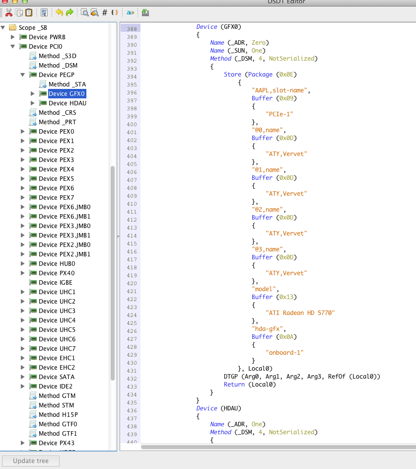

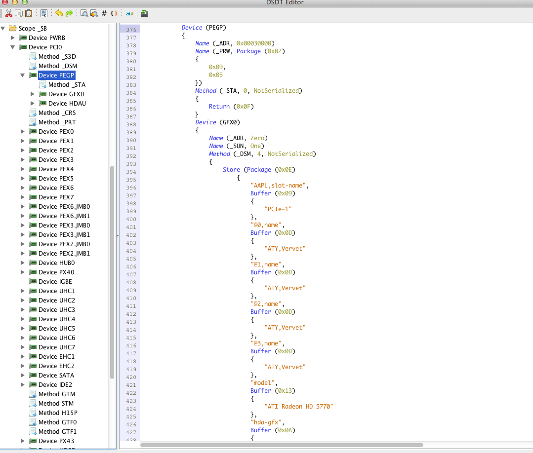

iFIRE Posted February 6, 2013 Share Posted February 6, 2013 Inject your card in DSDT.aml, forme work all ports. HD 5770.rtf Link to comment https://www.insanelymac.com/forum/topic/286177-ati-5570-no-dvi-e-hdmi/#findComment-1886473 Share on other sites More sharing options...

iFIRE Posted February 6, 2013 Share Posted February 6, 2013 Change your SMBIOS for Mac Pro5,1, put in your org.boot.plist, see if this work for you <key>AtiConfig</key> <string>Vervet</string> <key>AtiPorts</key> <string>04</string> <key>DSDT</key> <string>/Extra/DSDT.aml</string> HD5770DSDTPatched.zip Link to comment https://www.insanelymac.com/forum/topic/286177-ati-5570-no-dvi-e-hdmi/#findComment-1886521 Share on other sites More sharing options...
