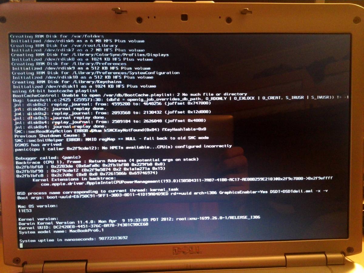

Turaiel Posted February 6, 2013 Author Share Posted February 6, 2013 I found the issue with Chameleon not starting. It was because the method in the guide was for Lion only. I got a copy of Lion from my roommate (who owns a Mac), and I was able to complete the first 17 steps. Now I'm stuck at a kernel panic saying "No HPETs available...CPU(s) configured incorrectly". I've attached a photo. Here's what I've tried: Used the DSDT with the guide, flags: acpi=i386 -x -v -x -v ForceHPET=Yes acpi=i386 GraphicsEnabler=Yes ForceHPET=Yes -x -v I also used the DSDT here: http://www.osx86.net...on_1520_a9.html with the same flags. I tried to use the guide you posted to patch the DSDT, but it would have taken me hours to get all the code corrected. Also, I wasn't really sure if all of it would apply to my machine. Link to comment https://www.insanelymac.com/forum/topic/286158-solved-unable-to-install-on-inspiron-1520/#findComment-1886427 Share on other sites More sharing options...
LatinMcG Posted February 6, 2013 Share Posted February 6, 2013 try -v -f also check your dsdt to the one u dloaded.. memory size prob dont match Link to comment https://www.insanelymac.com/forum/topic/286158-solved-unable-to-install-on-inspiron-1520/#findComment-1886498 Share on other sites More sharing options...
Turaiel Posted February 6, 2013 Author Share Posted February 6, 2013 I tried those flags with no DSDT, and with the two DSDTs, and I just got the same kernel panic. Link to comment https://www.insanelymac.com/forum/topic/286158-solved-unable-to-install-on-inspiron-1520/#findComment-1886500 Share on other sites More sharing options...
LatinMcG Posted February 6, 2013 Share Posted February 6, 2013 dump your dsdt .. do from linux or windows. then we compare the memory line. Link to comment https://www.insanelymac.com/forum/topic/286158-solved-unable-to-install-on-inspiron-1520/#findComment-1886501 Share on other sites More sharing options...
Turaiel Posted February 6, 2013 Author Share Posted February 6, 2013 Alright, I started a live CD and used acpidump to retrieve it. It's attached. dsdt.aml.zip Link to comment https://www.insanelymac.com/forum/topic/286158-solved-unable-to-install-on-inspiron-1520/#findComment-1886508 Share on other sites More sharing options...
LatinMcG Posted February 7, 2013 Share Posted February 7, 2013 i see problem. the HPET is not fixed in that dsdt ill fix it here u go http://www.mediafire.com/?s1u6rb4ys56m669 i cant test as i sold my 1520 nvidia 8600 .. but i do have 1520 intel video card that is harder to get to work due to intel video changes in 10.7 1 Link to comment https://www.insanelymac.com/forum/topic/286158-solved-unable-to-install-on-inspiron-1520/#findComment-1886726 Share on other sites More sharing options...
