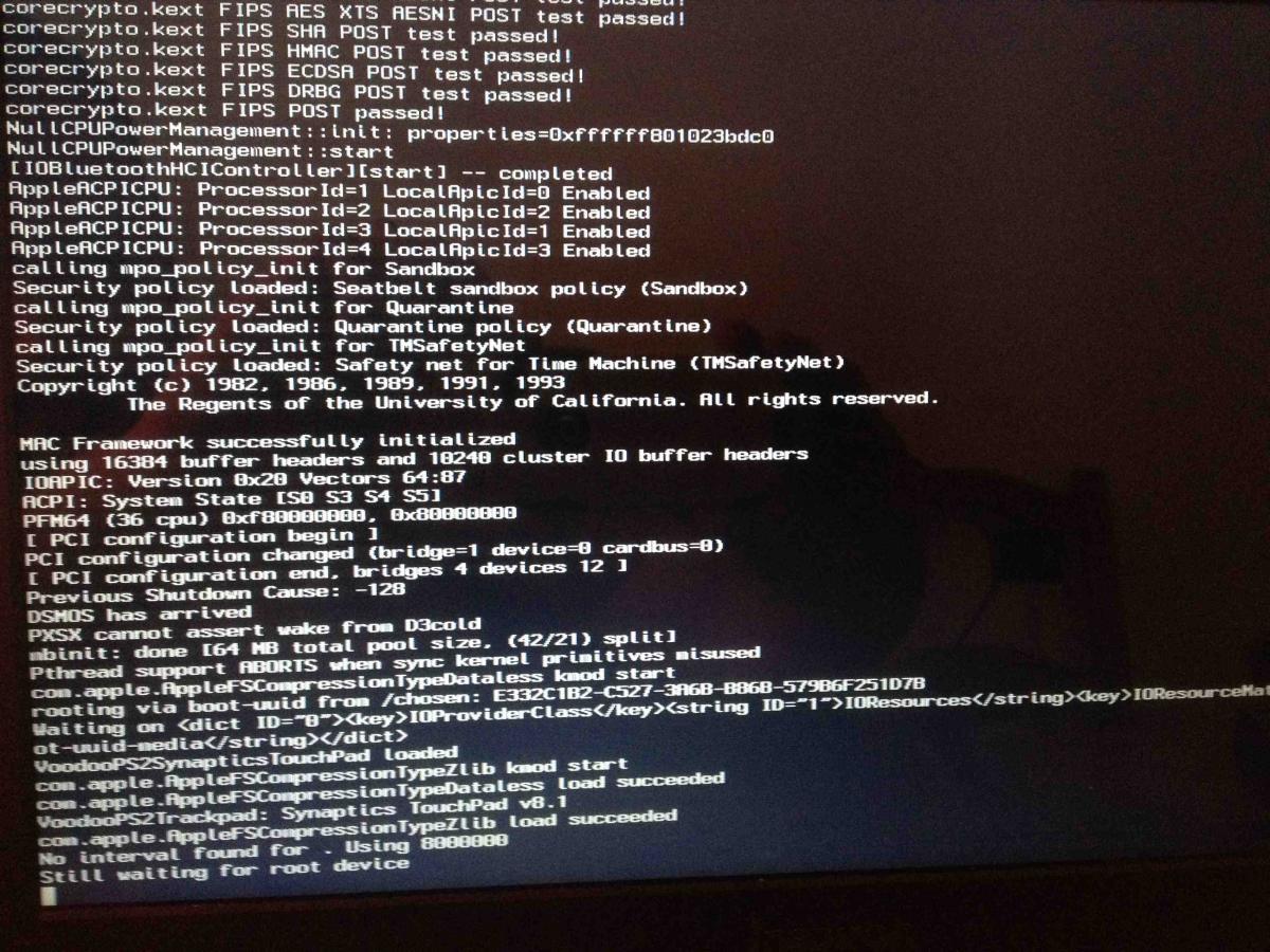

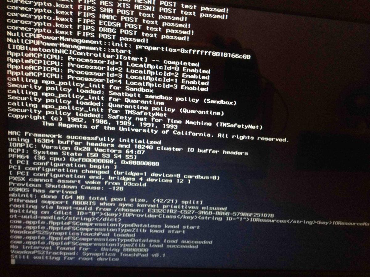

jl4c Posted February 4, 2013 Share Posted February 4, 2013 Hi all, Am trying to install ML 10.8.2 on this machine, this is what i've done: 1) make a uni### (1.7.0) USB with ML 10.8.2 2) Set Sata option to ACHI in bios 3) boot in verbose mode, but i get "Still waiting for root device". i tried all flags kernel 4) I think this issue is due to USB 3.0, so i've put the PXHCD extension in Extra folder of ##### (1.7.0) USB 5) With that extension, i can boot and reach the installation screen BUT ONLY IN SECURE MODE. Finished installation, and there is no way to boot without secure mode and neither make to work the HD 4000 after install multi### (5.2.1) (No DSDT) Specs: Intel® Core™ i5-3317U CPU @ 1.70GHz Intel HM77 Chipset Intel HD 4000 Video 6.00 GB RAM 500GB HDD 32GB SSD Atheros 9285 Qualcomm Atheros AR8162 PCI-E Fast Ethernet Controller (NDIS 6.30) IDT High Definition Audio Only 2 USB port and both are 3.0 Please guys help me, i tried all the things that i know and readed all the posts here and there Link to comment https://www.insanelymac.com/forum/topic/286144-dell-inspiron-14z-5423-only-in-secure-mode/ Share on other sites More sharing options...

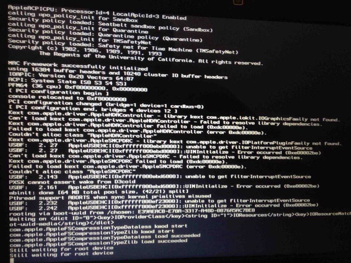

jl4c Posted February 5, 2013 Author Share Posted February 5, 2013 Update: i've remake a uni### USB with Legacy USB support and now is not necessary to put the PXHCD extension on it. But am still can't boot without -x flag Link to comment https://www.insanelymac.com/forum/topic/286144-dell-inspiron-14z-5423-only-in-secure-mode/#findComment-1886158 Share on other sites More sharing options...

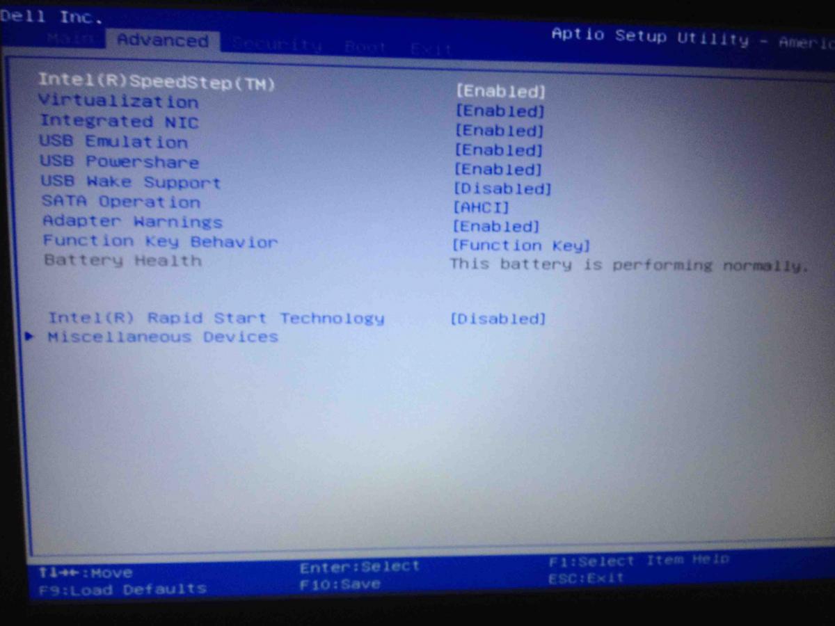

jl4c Posted February 5, 2013 Author Share Posted February 5, 2013 Wow, muchas gracias iFIRE. En cuanto a los puertos USB, este laptop sólo tiene 2 puertos y ambos son USB 3.0 De las opciones que dices, en la BIOS de este equipo sólo se puede modificar el modo AHCI (adjunto foto) He re-creado el USB, usando la herramienta mencionada, pero esta vez he eliminado la carpeta Extra y puesto en su lugar la que has creado para mi Pregunta: Si el problema son los puertos USB 3.0; no sería bueno probar con un DVD? iFIRE, también adjunto el archivo DSDT sin compilar aún (.dsl) extraído desde Linux. Estos son los resultados: dsdt.zip Link to comment https://www.insanelymac.com/forum/topic/286144-dell-inspiron-14z-5423-only-in-secure-mode/#findComment-1886259 Share on other sites More sharing options...

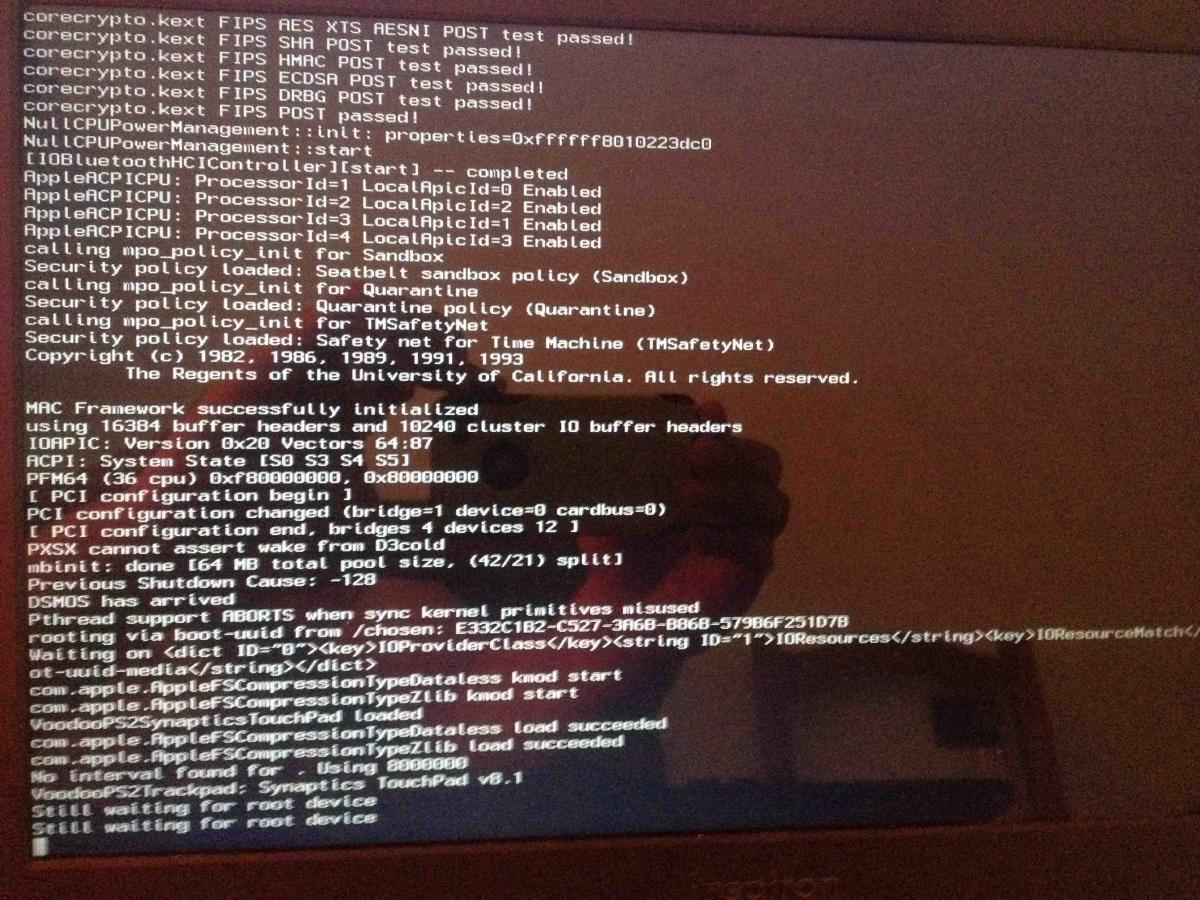

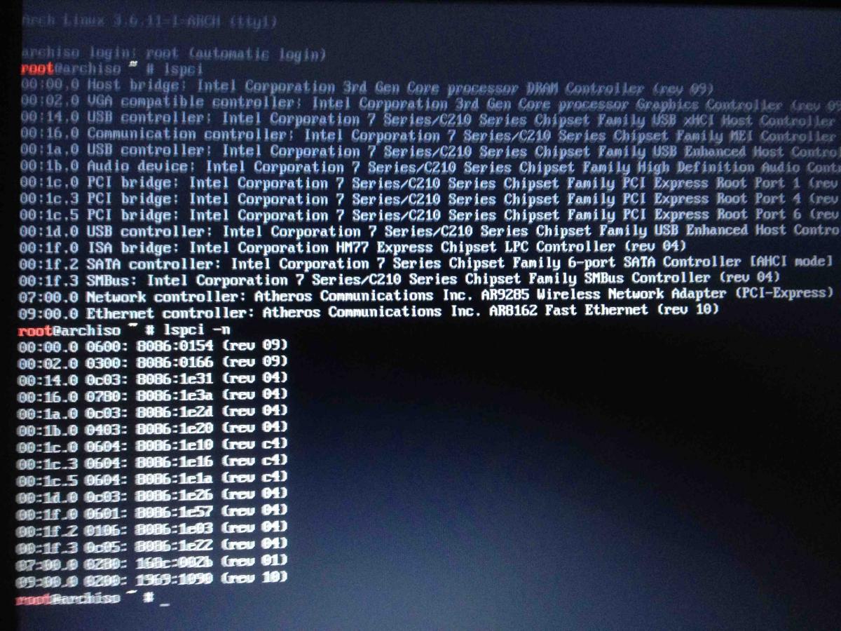

iFIRE Posted February 5, 2013 Share Posted February 5, 2013 me puedes mandar lspci -nn de tu hardware, voy a editar algunos kexts para ver si suluciona tu problema Prueba dar el boot com esta flag, UseKernelCache=No busratio=17 -v GraphicsEnabler=No npci=0x2000 DSDTpatched.zip Link to comment https://www.insanelymac.com/forum/topic/286144-dell-inspiron-14z-5423-only-in-secure-mode/#findComment-1886284 Share on other sites More sharing options...

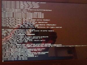

jl4c Posted February 5, 2013 Author Share Posted February 5, 2013 Aqui está el lspci, voy a probar esos flags. Gracias Acá esta el screenshot con los flags sugeridos lspci-nn.zip Link to comment https://www.insanelymac.com/forum/topic/286144-dell-inspiron-14z-5423-only-in-secure-mode/#findComment-1886286 Share on other sites More sharing options...
