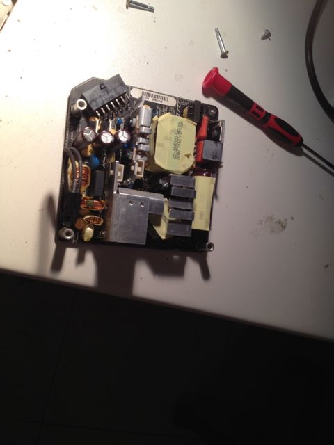

idog Posted January 2, 2013 Share Posted January 2, 2013 Hi there, First poster here I have a dead iMac 21.5" here, mid 2010 model. It was running the other day, then all of a sudden it looked like the power was severed and the power in the entire house went off as well (circuit breaker). From then I've tried other outlets, other cables, but the iMac was dead. I checked the diagnose leds on the logic board and they are all off when the AC cable is connected. Checking diagnostic points on the logic board (tried 1-4) yielded no 12v. (nothing actually). I then measured the incoming ac points on the power supply and it read 225 volts (I live in Europe, so this is correct ). However, upon checking all the outgoing rails, none had power. So I concluded the power supply is faulty. Easy fix (and most expensive one) is replacing it. However, I'm looking for a more DIY solution (replacing fuses/caps). Anyone got any pointers/schematics to do this for this iMac model ? Thanks for any insights ! idog Link to comment https://www.insanelymac.com/forum/topic/285388-imac-215-mid-2010-with-dead-power-supply/ Share on other sites More sharing options...
