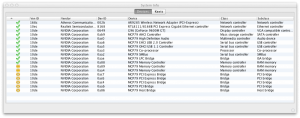

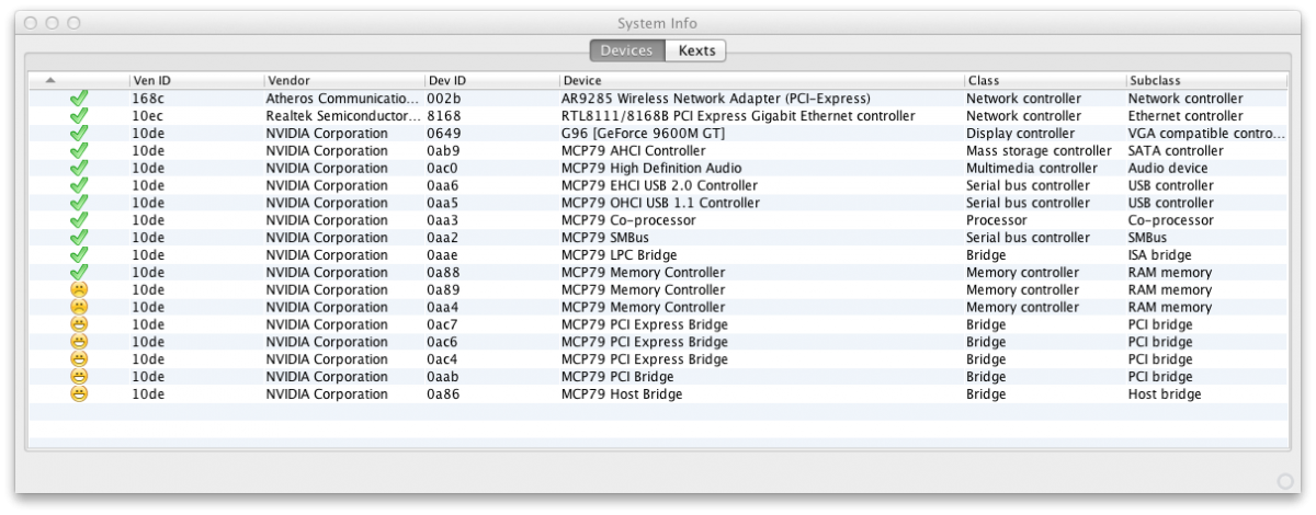

markusssss86 Posted December 4, 2012 Author Share Posted December 4, 2012 vi allego un'altra info puo essere utile Link to comment https://www.insanelymac.com/forum/topic/284722-ram-4gb-riconosciuta-ma-solo-in-parte/#findComment-1870980 Share on other sites More sharing options...
