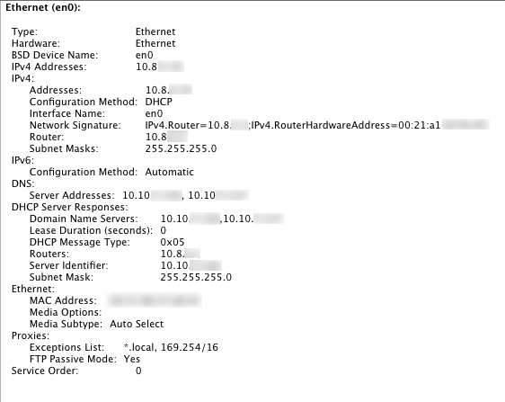

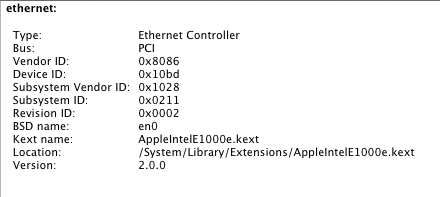

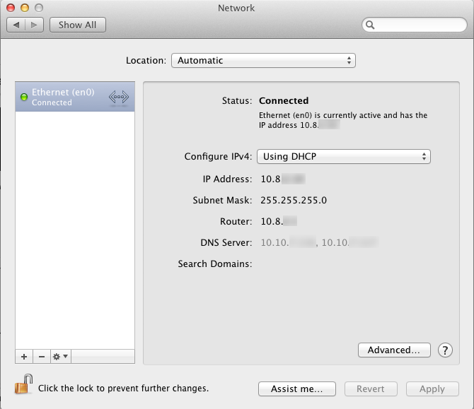

Chris. Posted September 10, 2012 Share Posted September 10, 2012 I have just setup an Optiplex 755 specs are below. When I try to login with an Apple ID to be able to access the Mac App store I get the following error "An unknown error has occurred" most people report this issue as an incorrect ethernet adaptor. I've tried several things suggested from installing an AppleIntelE1000e.kext the blowing away the NetworkInterfaces.plist and deleting and rebuilding the network connection under preferences to ensure en0 was the ethernet connection being used and repaired permissions, so far nothing has worked. Optiplex 755 - BIOS A19 - Q6700 - 2.66 GHz Core 2 Quad - 4GB (2x 2GB) Samsung DDR2 Memory - Integrated Intel 82566DM Ethernet (enabled with Intel82566MM.kext and AppleIntelE1000e.kext) - Integrated ADI 1984 High Definition Audio (enabled with VoodooHDA.kext) - EVGA Geforce 8000GT (enabled with NVEnabler64.kext) I've attached some images showing system reports and Preference settings incase they help. Link to comment https://www.insanelymac.com/forum/topic/282681-any-solution-an-unknown-error-has-occurred/ Share on other sites More sharing options...
