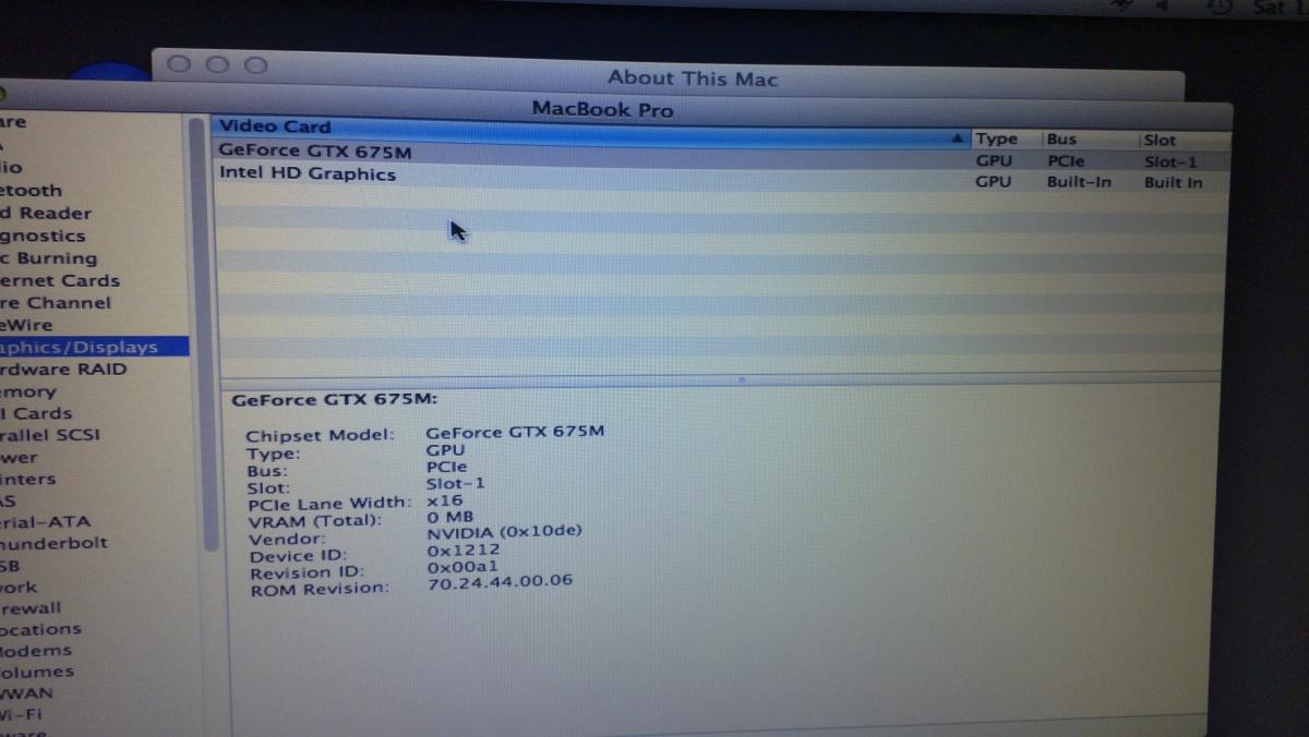

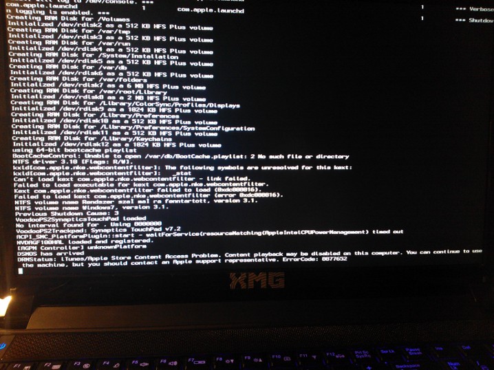

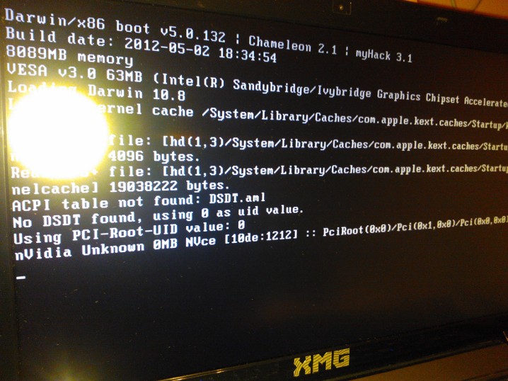

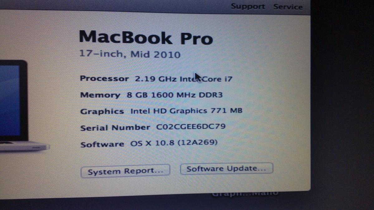

aFagylaltos Posted August 30, 2012 Share Posted August 30, 2012 Hi! I have this notebook: http://www.notebookc...ok.72895.0.html XMG P502 PRO Gaming Notebook 39,6cm (15.6") / Sager NP9150 / Clevo P150EM . 39,6cm (15.6") Full-HD (1920*1080) Non-Glare . NVIDIA GeForce GTX 675M 2048MB GDDR5 . Intel Core i7-2670QM - 2,20 - 3,10GHz 6MB . 8GB (2x4096) SO-DIMM DDR3 RAM 1600MHz . 750GB SATA-II 7200U/Min Seagate Momentus 7200.5 (ST9750420AS) . DVD SATA Multinorm Brenner . Intel Centrino Wireless-N 1030 (inkl. Bluetooth) -------------------------------------- -Intel HD Graphics 3000 -NVIDIA GeForce GTX 675M -------------------------------------- 1. I download the 10.8 ML ( ~4GB | InstallESD.dmg ) 2. MyHack-3.1.2 create the usb install. 3. Whenn I boot this flag: -v , I got this error: nVidia unknown 0MB NVce 4. I fixed it this flags: -v GraphicsEnabler=No 5. Then I got this error: DRMStatus: iTunes/Apple Store Content Access Problem. Content playback may be disabled on this computer. You can continue to use the machine, but you should contact an Apple support representative. ErrorCode: 8877652 I fixed it with these: mkdir /GeriOSX/ mv /System/Library/Extensions/AppleIntelSNBGraphicsFB.kext/ /GeriOSX/ 6. Then I was able to install without problems with this flags: GraphicsEnabler=No -v -f 7. I install the 3087-Chameleon-2.1svn-r2047, and I can boot GraphicsEnabler=Yes, but I don't have graphics acceleration. 8. I install Intel HD Graphics By Mano kext ( from osx86.net ) HD 3000 work, but gtx 675M dosen't work I can't work without the graphics acceleration. please help me thanks!, Link to comment https://www.insanelymac.com/forum/topic/282377-sager-np9150-with-intel-hd-3000-and-gtx-670m-optimus/#findComment-1848945 Share on other sites More sharing options...
