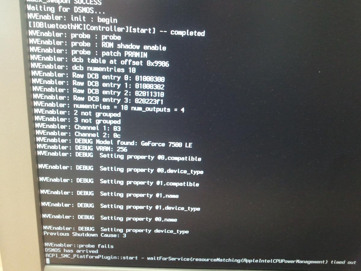

nick93 Posted August 22, 2012 Share Posted August 22, 2012 I have two HP Pavillions m7680.nl-a and in one I've replaced my graphics card with a Geforce 210. That computer is running on Mountain Lion without any issues. The other one is equipped with a Geforce 7500 and the installation goes fine, it boots in safe mode, but will not boot in normal mode. It asks for a reset. When I try to boot with -v it gives the screen included in the attachment. As you can see I've tried to install NVEnabler64.kext and I've put the EFI string in org.chameleon.Boot.plist and set GE=Y as well in safe mode. Does anyone have any clue how this could be solved? Link to comment https://www.insanelymac.com/forum/topic/282097-mountain-lion-geforce-7500-le/ Share on other sites More sharing options...
VirtualGuitarist Posted August 23, 2012 Share Posted August 23, 2012 Hi, i have the same problem, i have a 7600 GS... The problem s that geforce nv40 kexts are 32 bits, and ML is 64 bits only.... Like you i've tried different nvenablers but no luck. So for now it's a dead end. The only real solution could be to have a 32 bits kernel (like the Netkas one) + 32 bits efi, and specially edited system kexts, but it's a lot of work, i hope some wonderful developper will find a solution for our problem, we're not the only ones to have unsupported / old hardware, it also interests all those who have Macpro 1,1 or old Macbooks... For example, you could read this, you'll see that a LOT of people is concerned! Link to comment https://www.insanelymac.com/forum/topic/282097-mountain-lion-geforce-7500-le/#findComment-1846646 Share on other sites More sharing options...
