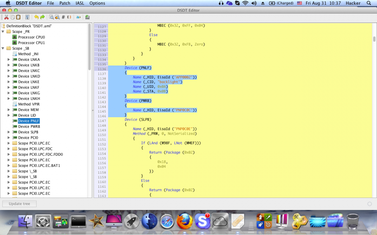

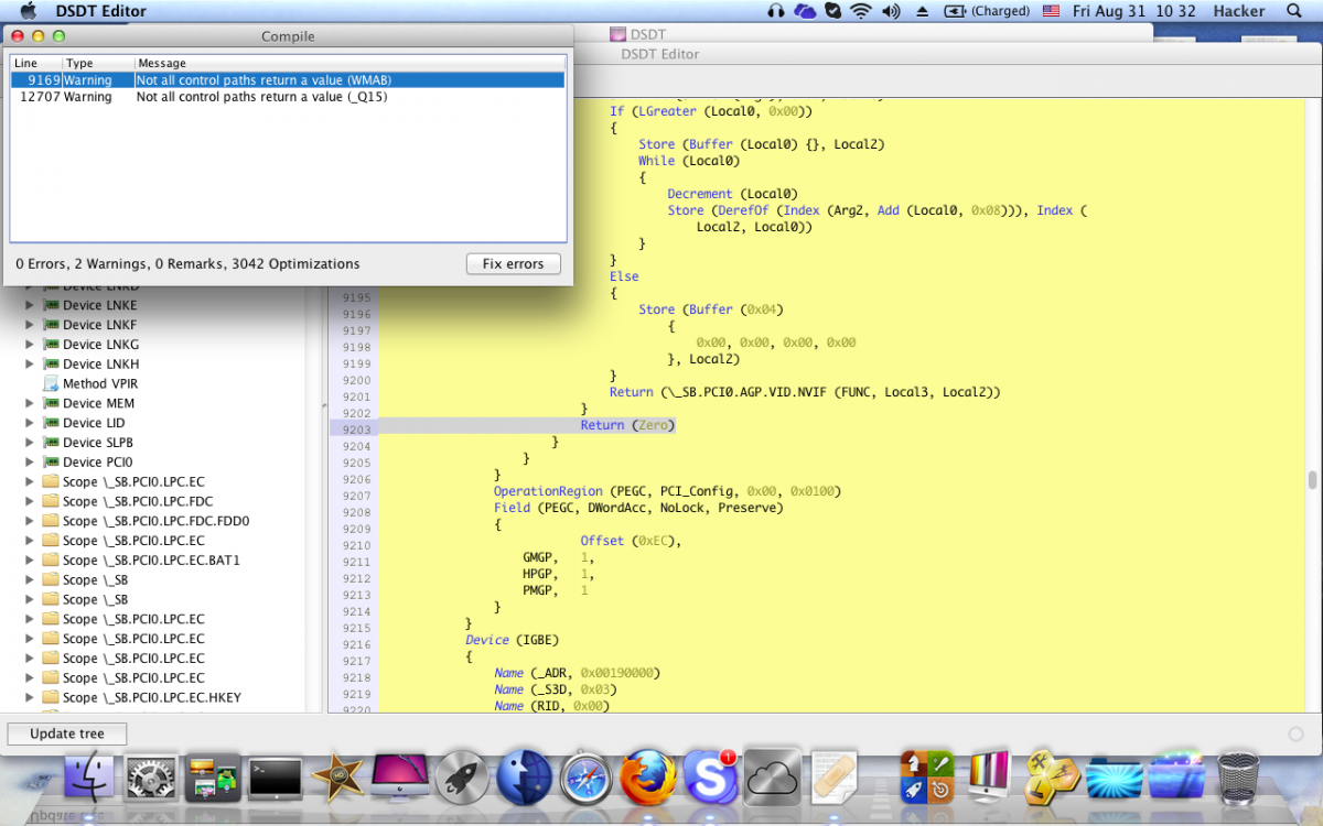

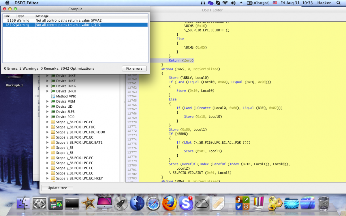

HUSABER Posted August 31, 2012 Author Share Posted August 31, 2012 Hey can you tell me what changes have you done than the previous DSDT? I want to know because i'm learning DSDT Editing... thanks HOW TO FIX:First time start from untuched DSDT.aml,and get two errors-Value (WMAB and Q15) i fixed it with Return (Zero) Next time i add only Device PNLF and PWRB(for my T61 corect directory is under Device LID...If change this 2 Device direrctory Sleep dont work,Fan,CPUrunning and Lid no go to sleep) Now is fixed..but me dont get another patch like DTGP,RTC,USB and EHCI If get patch sleep dont work.... THIS IS ALL from ME.......Thanks again giofrida LatestT61.aml.zip Link to comment https://www.insanelymac.com/forum/topic/281449-help-for-t61-sleep/page/2/#findComment-1849252 Share on other sites More sharing options...
