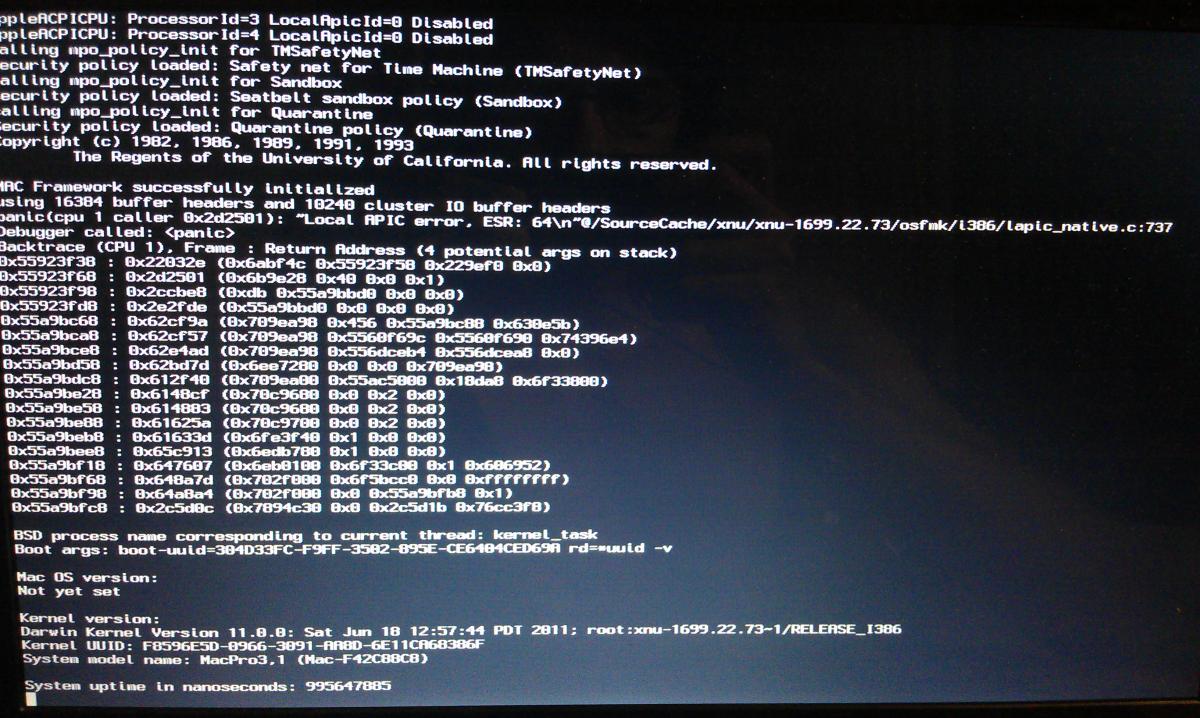

Dllop8 Posted July 31, 2012 Share Posted July 31, 2012 Hi everyone, First of all sorry for my bad english, I'll try to explain my problem as well as I can. I Have an HP Dv6 1340ss (two or three years ago) and I want to install Os X Lion on it. I have Lion in another two desktop computers (Installed with the same DVD, iAtkos L1) But in this laptop, when the DVD starts to load, appears a message on screen asking for reboot. I tried to enter with "-v" to see the error and I take a picture. (If you can't read the text tell me and I'll write the completely screen). Thank you very much for reading. Link to comment https://www.insanelymac.com/forum/topic/281322-mac-os-x-lion-on-hp-dv6-1340ss/ Share on other sites More sharing options...
giofrida Posted July 31, 2012 Share Posted July 31, 2012 That's a kernel panic, but i can't see all the text. If you can, attach another image with full text. Anyway, try to boot with these flags: -v cpus=1 -v GraphicsEnabler=No -v -x cpus=1 1 Link to comment https://www.insanelymac.com/forum/topic/281322-mac-os-x-lion-on-hp-dv6-1340ss/#findComment-1839454 Share on other sites More sharing options...

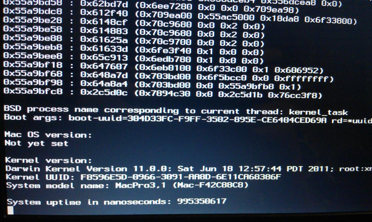

Dllop8 Posted July 31, 2012 Author Share Posted July 31, 2012 That's a kernel panic, but i can't see all the text. If you can, attach another image with full text. Anyway, try to boot with these flags: -v cpus=1 -v GraphicsEnabler=No -v -x cpus=1 Thanks for your quickly reply! I tried the first flag and stops here: [ PCI Configuration begin] With the second flag stops in the same line as normal "-v" And the last flag gives the same result as -v cpus=1 (But needs more time to show the PCI Configuration begin) I go to make a good picture/s of the first kernel panic to show you. Hi again, I made a new picture, I hope you can make zoom on it to read the problem ^^ Link to comment https://www.insanelymac.com/forum/topic/281322-mac-os-x-lion-on-hp-dv6-1340ss/#findComment-1839482 Share on other sites More sharing options...
giofrida Posted July 31, 2012 Share Posted July 31, 2012 Oh, the kernel panic appears while you don't input the flag "cpus=1". So, try these flags: npci=0x2000 -v cpus=1 npci=0x3000 -v cpus=1 npci=0x2000 -v -x cpus=1 npci=0x3000 -v -x cpus=1 EDIT: also try these: npci=0x2000 -v cpus=1 PCIRootUID=1 npci=0x3000 -v cpus=1 PCIRootUID=1 If no flags is working, you should make an Lion/Mountain Lion Retail USB. If you need help to create it, PM me. Link to comment https://www.insanelymac.com/forum/topic/281322-mac-os-x-lion-on-hp-dv6-1340ss/#findComment-1839502 Share on other sites More sharing options...
