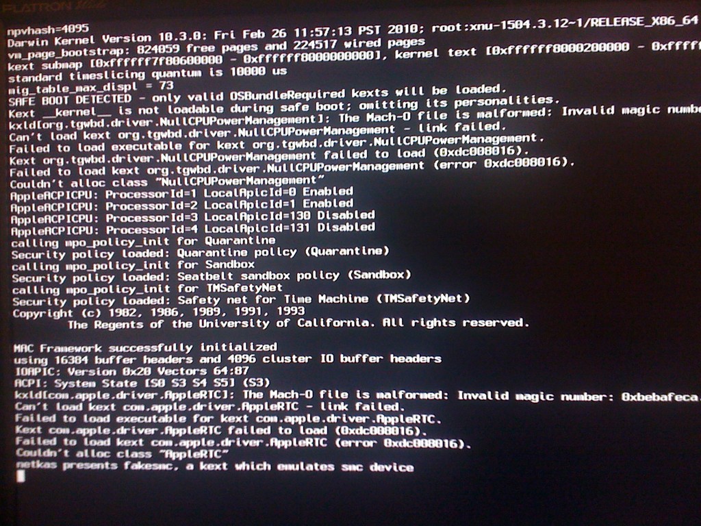

B748i Posted July 3, 2012 Share Posted July 3, 2012 I first attempted using ... a boot image which has a name that is apparently censored here. It would just get stuck on the grey screen when starting the install. I then tried ModCD. This allowed the install to complete. Trying to boot results in an error in the boot loader that it can't find legacy_kernel. (I think? Didn't write that one down) I can then attempt to boot with mach_kernel, but it freezes part way through. It always stops at netkas presents fakesmc. I've tried -x, -F, -x -F, each delivers similar results. (mach_kernel and -v on all of them) Attached is a picture of the screen where it fails. I only get to work on this a few hours a week, and it's my main computer the rest of the time, no 2nd box to simultaneously look stuff up. There are a lot of other command options that I don't yet have time to fully investigate. Hopefully the information in this post might be enough to get help narrowing down what to try next. Specs: Retail Snow Leopard disc Motherboard: MSI G41TM-E43. Next to the model it has printed "MS - 7592" and "VER : 2.0" G41 chipset, revision A3. Southbridge ICH7/R, revision A1. BIOS 4.3 CPU: Core 2 Duo E6600, original Conroe bought right after Core 2 release. VIDEO: ATI Radeon HD 4870, 512MB, BIOS 011.003.000.001.029254 (113-G50701-100) LAN: D-Link DWA-556 Wireless (This was disconnected during installation). No wired network available. HDD: WD Velociraptor 300GB (WDC WD3000GLFS-01F8U0, firmware 03.03V01) This was the only HDD connected. DVD: LiteON iHAS324 Thanks! Link to comment https://www.insanelymac.com/forum/topic/280256-not-sure-what-to-do-next-msi-g41tm-e43/ Share on other sites More sharing options...
B748i Posted July 3, 2012 Author Share Posted July 3, 2012 My screenshot didn't make it in somehow. Here it is. Link to comment https://www.insanelymac.com/forum/topic/280256-not-sure-what-to-do-next-msi-g41tm-e43/#findComment-1830997 Share on other sites More sharing options...

rlf Posted July 4, 2012 Share Posted July 4, 2012 It says there is a problem with the AppleRTC.kext. Try the following. Boot "mach_kernel -s" without the quotes. This will put you into a command line environment. When you see the prompt "root:", then: Type: mount -uw / Type: cd /System/Library/Extensions Type: chown -R root:wheel AppleRTC.kext Type: chmod -R 755 AppleRTC.kext Then reboot "mach_kernel -v". Link to comment https://www.insanelymac.com/forum/topic/280256-not-sure-what-to-do-next-msi-g41tm-e43/#findComment-1831182 Share on other sites More sharing options...
