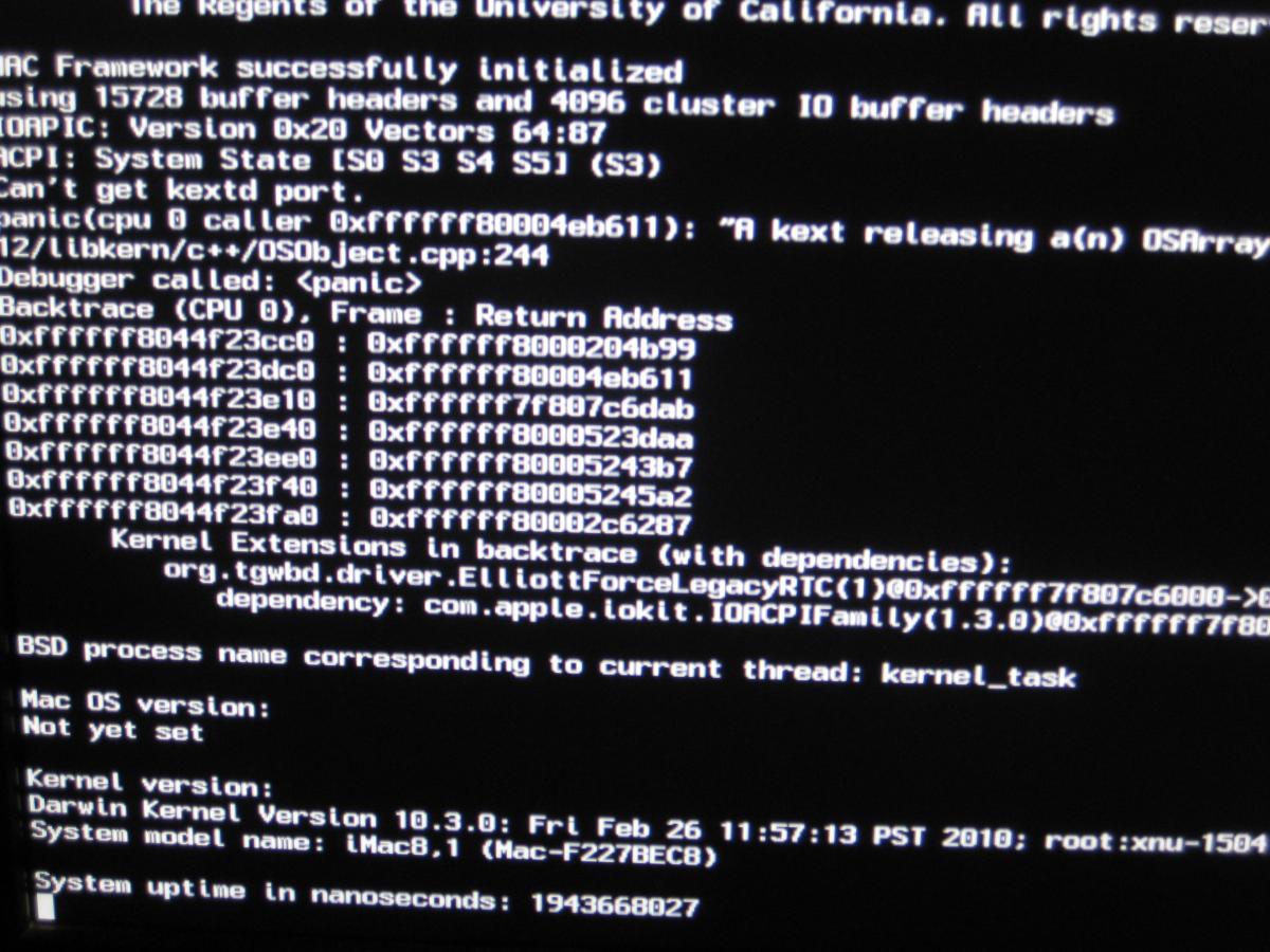

sags95 Posted May 15, 2012 Share Posted May 15, 2012 i seem to be getting a kernal panic by the elliotforcelegacy kext i believe and i tried to remove it through the terminal on the install disk but im not sure im doing it properly can anyone give me instructions on how to remove it? Intel DP965LT mobo 3 GB Ram 667 Mhz Intel Core 2 Duo 2.4 Ghz ATI x1950 pro 160 GB SATA 3 HDD Onboard LAN Quote Link to comment https://www.insanelymac.com/forum/topic/279056-getting-an-elliotforcelegacykext-kernal-panic/ Share on other sites More sharing options...

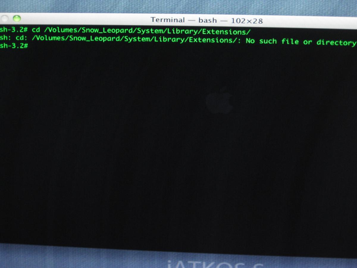

sags95 Posted May 15, 2012 Author Share Posted May 15, 2012 Install media > Utilities > Terminal > cd /Volumes/your_partition_name_here_/System/Library/Extensions rm -r ElliotForceLegacyRTC.kext cd .. touch /Extensions reboot Sorry if i seem like a complete noob at this, its my first build, but when i try to navigate to that directory it says no such file or directory its weird because the partition is named Snow Leopard and it says the mount point is Volumes/Snow Leopard/ in the disk utilities... Quote Link to comment https://www.insanelymac.com/forum/topic/279056-getting-an-elliotforcelegacykext-kernal-panic/#findComment-1820616 Share on other sites More sharing options...
.picodev Posted May 15, 2012 Share Posted May 15, 2012 You have to use the breakout character for the spaces.. \ , so it would be "cd /Volumes/Snow\ Leopard/System/Library/Extensions" One more quick tip,when you know the names of folders,example just type Sno and press Tab,it will autocomplete the name for you. Quote Link to comment https://www.insanelymac.com/forum/topic/279056-getting-an-elliotforcelegacykext-kernal-panic/#findComment-1820618 Share on other sites More sharing options...

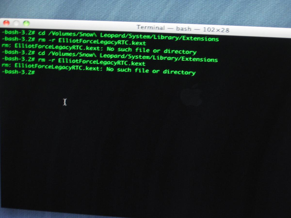

sags95 Posted May 15, 2012 Author Share Posted May 15, 2012 You have to use the breakout character for the spaces.. \ , so it would be "cd /Volumes/Snow\ Leopard/System/Library/Extensions" One more quick tip,when you know the names of folders,example just type Sno and press Tab,it will autocomplete the name for you. well i think i got passed the directory but then it says there is no such file for the elliotforcelegacyRTC kext Quote Link to comment https://www.insanelymac.com/forum/topic/279056-getting-an-elliotforcelegacykext-kernal-panic/#findComment-1820622 Share on other sites More sharing options...
.picodev Posted May 15, 2012 Share Posted May 15, 2012 Heh,it's with two "t" , so Elliott That's why i told you to use Tab and auto complete. Quote Link to comment https://www.insanelymac.com/forum/topic/279056-getting-an-elliotforcelegacykext-kernal-panic/#findComment-1820624 Share on other sites More sharing options...

sags95 Posted May 15, 2012 Author Share Posted May 15, 2012 i tried it again now and its saying that it cant find the kext so idk if thats because i already deleted it or something... Quote Link to comment https://www.insanelymac.com/forum/topic/279056-getting-an-elliotforcelegacykext-kernal-panic/#findComment-1820872 Share on other sites More sharing options...
sags95 Posted May 15, 2012 Author Share Posted May 15, 2012 anyways its all resolved now i deleted the volume and re-installed using nothing but the 32-bit RTC kext and it works, thanks so much for the help Quote Link to comment https://www.insanelymac.com/forum/topic/279056-getting-an-elliotforcelegacykext-kernal-panic/#findComment-1820884 Share on other sites More sharing options...
