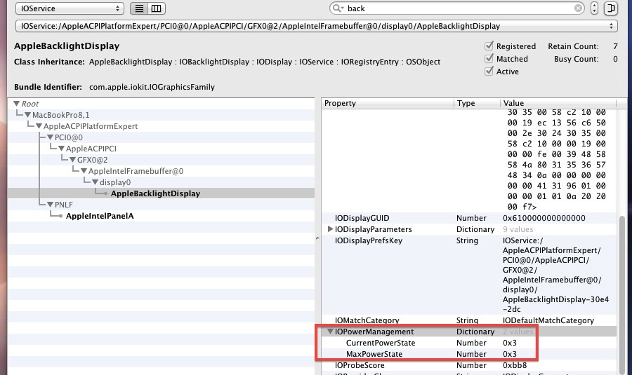

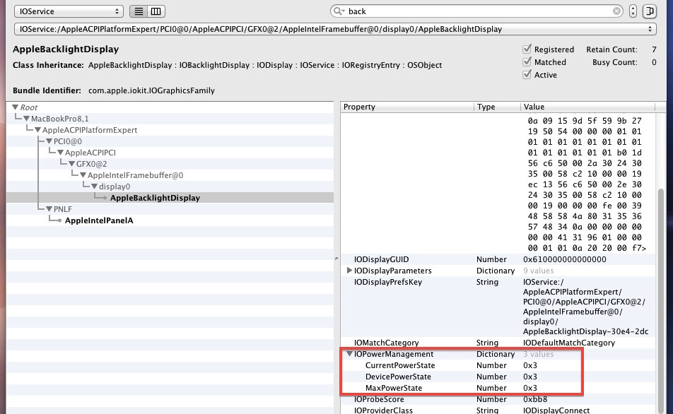

TUX FIRE Posted May 2, 2012 Share Posted May 2, 2012 Hello I have found something weird with the backlight function, well it's works fine, but the max brightness level isn't enough (about 80 or 90%) When the Mac wakes from sleep, the Brightness becomes higher than before (100%) In IOReg, i watched the "AppleBacklightDisplay", his property "IOPowerManagement" has 2 values before the standby : (CurrentPowerState & MaxPowerState) After the Wake, the property "IOPowerManagement" has 3 values : (CurrentPowerState, DevicePowerState & MaxPowerState) The Mac is under Ac Power not Battery, my DSDT is Patched. Any Ideas ?? Thank you. 1 Link to comment https://www.insanelymac.com/forum/topic/278633-problem-with-backlight/ Share on other sites More sharing options...
juanerson Posted May 3, 2012 Share Posted May 3, 2012 Very interesting, sure many people have the same report. And another example, when I put the display to sleep, or goes automatically to sleep (only the LID screen device) and wake up, it show three values. Not before. BUT maybe is normal? should be the expected behavior in a genuine macbook pro or Air with the HD 3000 GPU? Therefore, I think we need to compare IOREGS, before sleep and after wake, from the MBP8,1 and/or MBA4,2 of course running Lion. Link to comment https://www.insanelymac.com/forum/topic/278633-problem-with-backlight/#findComment-1817695 Share on other sites More sharing options...
