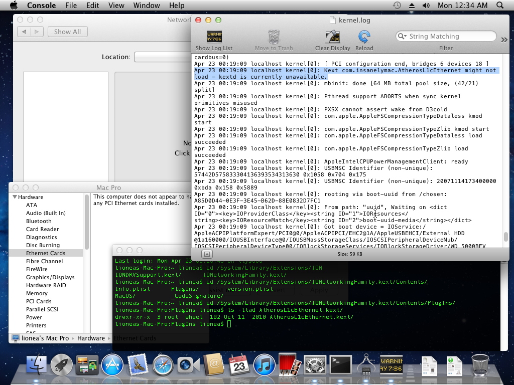

ea dd Posted April 22, 2012 Share Posted April 22, 2012 Hi, all i have installed Lion on Toshiba Satellite L655-S5078. it has Atheros AR8152/8158 PCI-e Fast Ethernet Controller [1969:2060]. so, i tried to install AtherosL1cEthernet.kext using M u l t i B e a s t 4.3.1 and did followings in terminal manually because M u l t i B e a s t seems copied kext and didnt repair owner. sudo -s chown -R root:wheel /System/Library/Extensions/IONetworkingFamily.kext/Contents/PlugIns/AtherosL1cEthernet.kext chmod -R 755 /System/Library/Extensions/IONetworkingFamily.kext/Contents/PlugIns/AtherosL1cEthernet.kext Added following lines in my org.chameleon.Boot.plist <key>EthernetBuiltIn</key> <string>Yes</string> Booted. Then Entered -v -f args to make sure to not using kernelcache But AtherosL1cEthernet.kext cant be loaded. kernel log says Kext com.insanelymac.AtherosL1cEthernet might not load - kextd is currently unavailable. also, i have tried with <key>EthernetBuiltIn</key> <string>No</string> Still got that error. and System Preferences shows no network adapter and System information is same. Attached screenshot. please help to solve that Atheros kext problem. Thanks. Link to comment https://www.insanelymac.com/forum/topic/278360-kext-cominsanelymacatherosl1cethernet-might-not-load/ Share on other sites More sharing options...

rlf Posted April 29, 2012 Share Posted April 29, 2012 M-beast installed the kext inside of IONetworkingFamily.kext. Most places where I find people using it is installed in /System/Library/Extensions. You might relocate the kext and perform your permissions again. Link to comment https://www.insanelymac.com/forum/topic/278360-kext-cominsanelymacatherosl1cethernet-might-not-load/#findComment-1816835 Share on other sites More sharing options...
