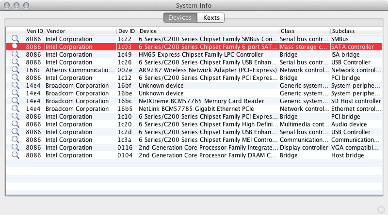

davidb8 Posted April 8, 2012 Author Share Posted April 8, 2012 had to install java which took forever over 3g lol vendor id = 168c vendor = atheros device id = 002e device = ar9287 (which is wrong it is a ar5b97) class = network controller subclass = network controller screenshot attached jpeg screenshot Untitled.tiff Link to comment https://www.insanelymac.com/forum/topic/277910-help-needed-after-lion-install-nearly-100-working/#findComment-1812064 Share on other sites More sharing options...
rlf Posted April 8, 2012 Share Posted April 8, 2012 The identifier for your wireless was in that wireless kext you previously installed. So it should have worked. Do you have a wi-fi power switch on your computer? These can cause problems because they leave the power to the wifi off during boot and therefore the card does not get detected and therefore loaded. For your ethernet, try this kext: http://www.osx86.net/view/1911-aspire_5750_broadcom_bcm57785.html Link to comment https://www.insanelymac.com/forum/topic/277910-help-needed-after-lion-install-nearly-100-working/#findComment-1812067 Share on other sites More sharing options...
