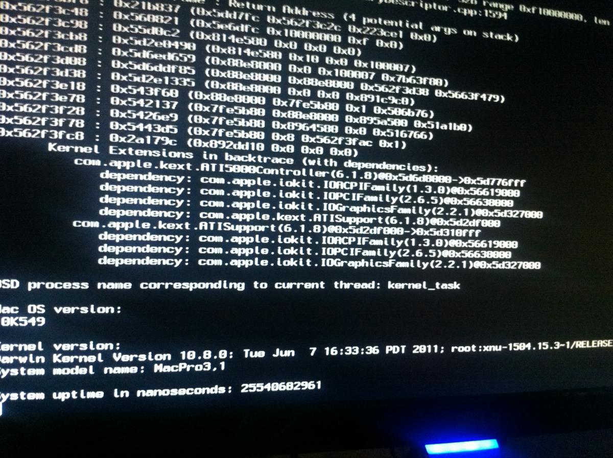

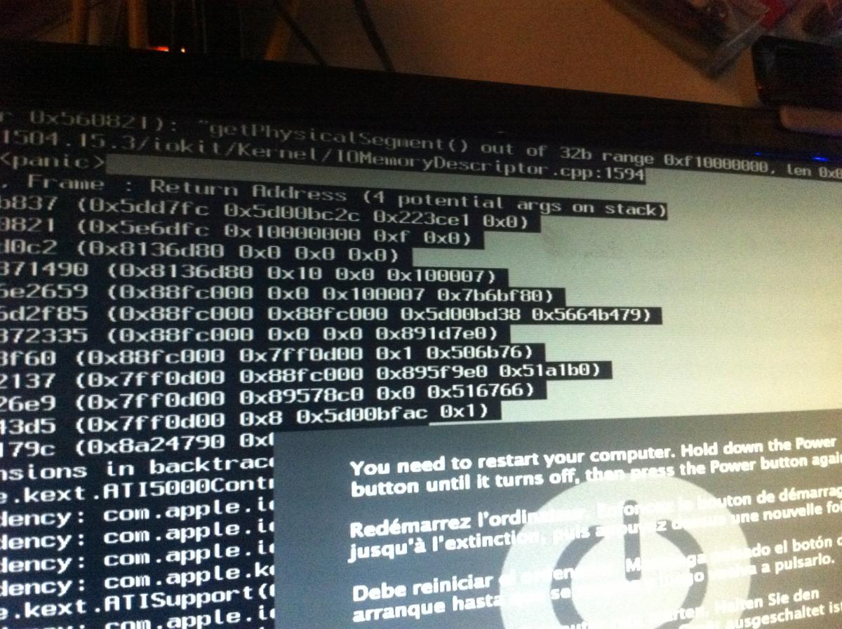

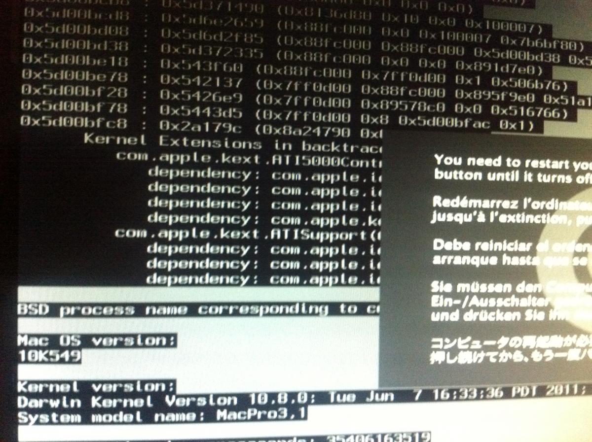

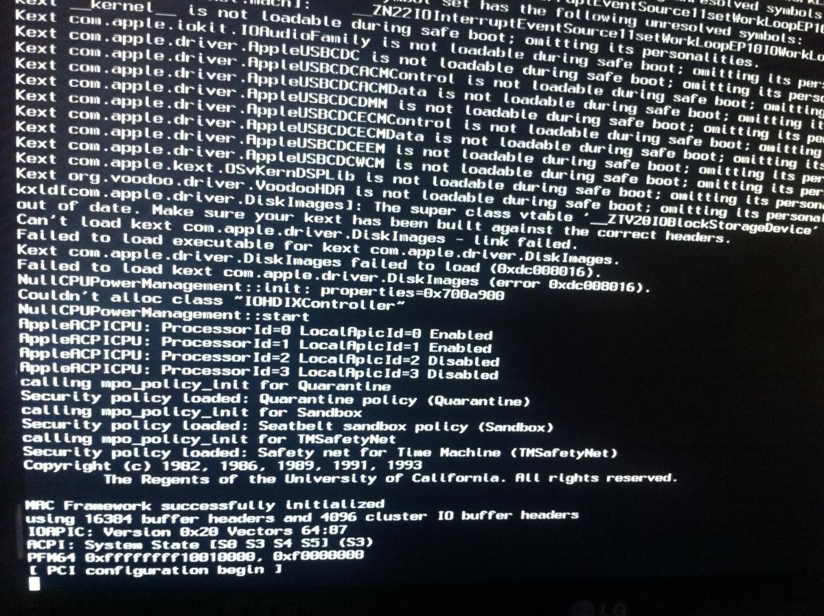

CamDAX Posted March 20, 2012 Share Posted March 20, 2012 Hello everyone I am having some kext issues with my hackintosh. Please help I have a major project I need to finish and I need my hackintosh for it. I have been trying to find the right kext for my ATI5770 graphics card and it the process I cant get my hackintosh to boot now, even in varaboos or safe mode. Single user gets me a terminal but its a read-only file system (I tried to delete the kexts i installed and it said "read only file system"). Below are photos of my boot up errors. https://docs.google.com/open?id=0B3mVj2ufceRbdzhLNGJ2V1ZRS1M3SUIxcUxLRnVNQQ Before my Hackintosh ran great with dual monitors but occasionally programs like Finder, Google Chrome, Open Office, and Picasa would freeze at random. My Hardware is MB: Gigabyte GA-G41M-ES2L Ram:4GB Graphics Card: Asus ATI5770 HDs -2TB for Data -200GB for hackintosh Link to comment https://www.insanelymac.com/forum/topic/277299-booting-and-other-errors/ Share on other sites More sharing options...
CamDAX Posted March 20, 2012 Author Share Posted March 20, 2012 I got it to boot into safe mode by booting single user waiting for the command prompt typing in "mount -rw /" typing "cd /System/Library/Extensions/" then typing "rm -rf (kext)" in my case the kext was ATI5000Controller.kext then I booted safe mode But I still need help. I need my second monitor working and my hackintosh fast again. Please Help CamDAX Link to comment https://www.insanelymac.com/forum/topic/277299-booting-and-other-errors/#findComment-1807351 Share on other sites More sharing options...
