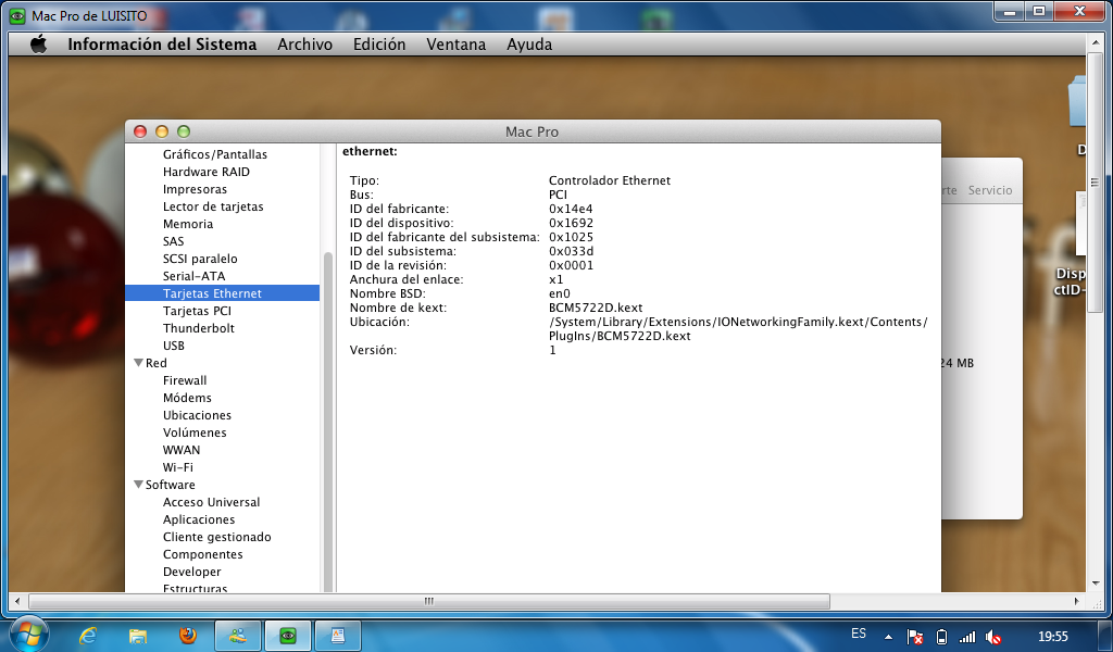

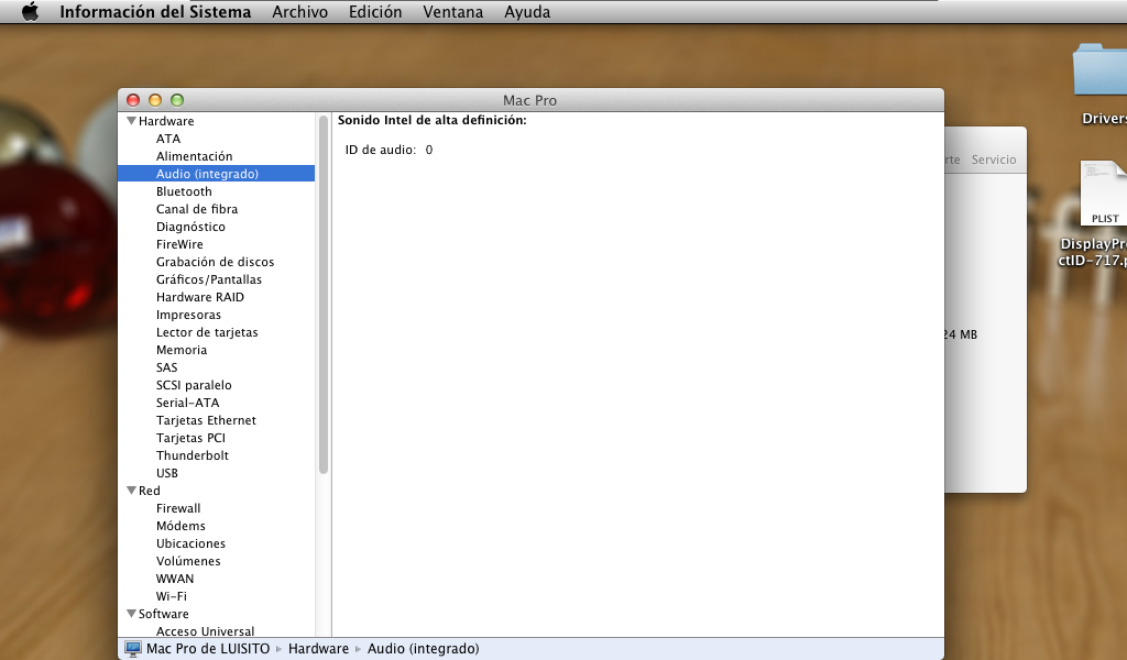

1) Sound -> RealTek ALC272 -> is OK (By kext)
2) Ethernet -> BroadCom BCM57780 --> is OK (By kext)

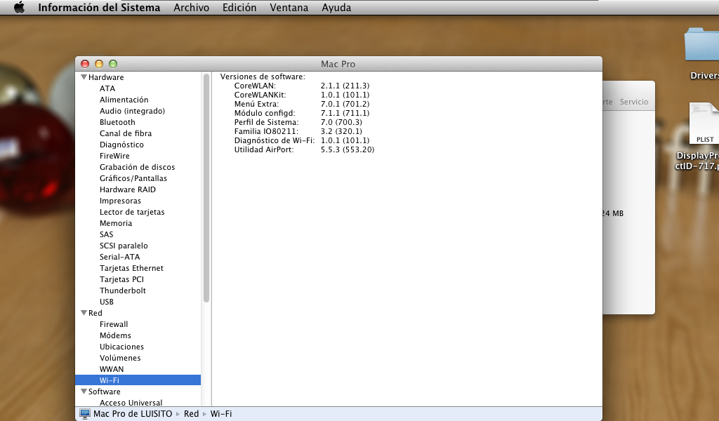

3) Wifi -> BroadCom BCM43225 --> Non Ok (I tried several options without results)
post-980345-0-33693000-1332193188_thumb.pngpost-980345-0-38608500-1332193189_thumb.png

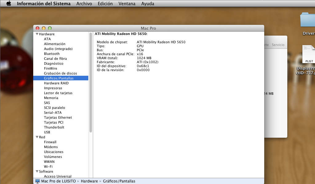

4) VERY IMPORTANT!! Graphics Card -> ATI Mobility Radeon HD 5650 --> Non Ok (I tried several options without results)
post-980345-0-71769200-1332193183_thumb.pngpost-980345-0-10582900-1332193185_thumb.png

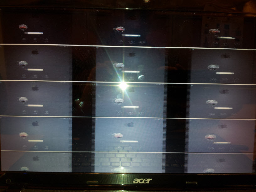

I tested with 3 monitors, but the screen always shows wrong (Multiple screens with horrible resolution) Attached image of the error:

I made the modification to the start of many AtiConfig=<option> and EDID AUO139E.
Graphics Card detected in all AtiConfig is ATI 5000, except Orangutan, showing ATI Mobility Radeon 5650 HD.
Alouatta	  -   Same screen error (multiple screens) and horrible resolution.
Baboon	   -   Same screen error (multiple screens) and horrible resolution.
Cardinal	  -   Black Screen, access with VNC is perfect, HDMI OK.
Caretta		-   Not start, panic Error.
Colobus	   -   Same screen error (multiple screens), horrible resolution , VNC is perfect.
Douc		   -   Same screen error (multiple screens) and horrible resolution.
Eulemur	  -   Same screen error (multiple screens) and horrible resolution.
Flicker		 -   Same screen error (multiple screens), horrible resolution , HDMi is perfect.
Galago		-   Same screen error (multiple screens) and horrible resolution.
Gliff			 -   Black Screen, access with VNC is perfect, HDMI OK.
Hoolock	   -   Same screen error (multiple screens) and horrible resolution.
Hypoprion	-   Black Screen, access with VNC is perfect, HDMI OK.
Iago			 -   Same screen error (multiple screens) and horrible resolution.
Kakapo		-   Black Screen, access with VNC is perfect.
Kipunji		   -   Same screen error (multiple screens) and horrible resolution.
Lamna		  -   Black Screen, access with VNC is perfect, HDMI OK.
Langur		  -   Same screen error (multiple screens) and horrible resolution.
Megalodon	-   Black Screen, access with VNC is perfect, HDMI OK.
Motmot		  -   Not start, panic Error.
Nomascus	 -   Not start, panic Error.
Orangutan  -   Black Screen, access with VNC is perfect, HDMI OK. Graphics Card -> ATI Mobility Radeon 5650 HD
Peregrine	 -   Black Screen, access with VNC is perfect, HDMI OK.
Quail			-   Not start, panic Error.
Raven		  -   Black Screen, access with VNC is perfect, HDMI OK.
Shrike		  -   Not start, panic Error.
Sphyrna	   -   Not start. System HALTED!!!
Triakis		 - Without Testing.
Uakari		 - Without Testing.
Vervet		  - Without Testing.
Zonalis		- Without Testing.
Conclusion: Lion does not detect my laptop's internal monitor so the screen does not show well with GraphicsEnabler = Yes. The only configuration that detects the graphics card correctly is Orangutan, but I get black screen on laptop screen.
Examples Orangutan ScreenShots by VNC:
What should I do?
