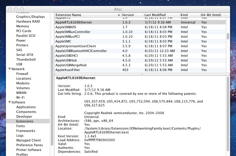

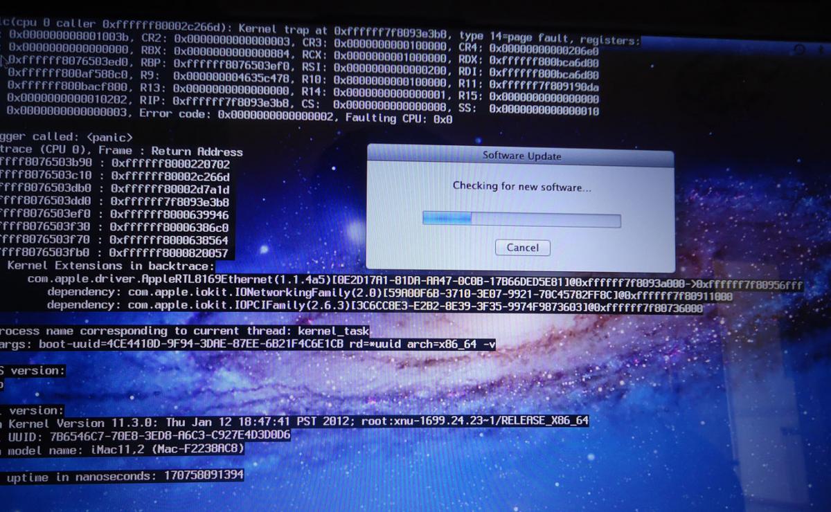

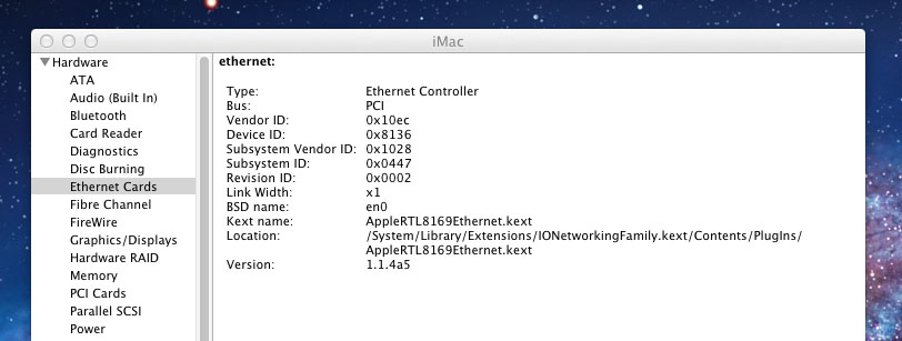

plsh2me Posted March 7, 2012 Share Posted March 7, 2012 Hi, Everyone I have installed Mac OS X Lion 10.7.3 on my Dell inspiron N5010, as i know realtek RTL8169 Ethernet is a working device on Mac OS X(wifi device bcm4313 looks like never working) . But it makes me hopeless . Kexts loads. when i connect to the internet it cause panic. It shows dependancy with IONetworkingFamily.kext & IOPCIFamily.kext. I have tried many other kexts of AppleRTLEthernet8169.kext, results same. Please help me, What should i do to make it working? Link to comment https://www.insanelymac.com/forum/topic/276849-realtek-rtl-8169-ethernet-kext-load-but-cant-use-cause-panic/ Share on other sites More sharing options...

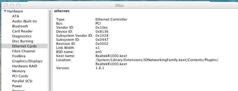

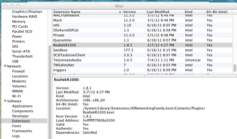

plsh2me Posted March 8, 2012 Author Share Posted March 8, 2012 @LatinMcG: Thanks for your reply. Problem solved . Actually I was wrong. My device id 8136 is works with the kext RealtekR1000.kext not Apple RTL8169Ethernet.kext. By loading this kext make me confused. So that I had tried to work Apple RTL8169Ethernet.kext and failed. Now my Ethernet device works perfectly with RealtekR1000.kext. Thanks.... Link to comment https://www.insanelymac.com/forum/topic/276849-realtek-rtl-8169-ethernet-kext-load-but-cant-use-cause-panic/#findComment-1804500 Share on other sites More sharing options...
