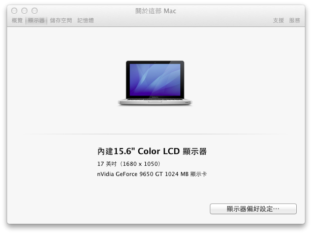

Leon Hong Posted February 22, 2012 Author Share Posted February 22, 2012 Errata: After further tweaking, I found nothing wrong EXCEPT the problematic NVDA,Display-A@0 driver sections. Now I can confirm it a driver problem, not dsdt nor any of my parts. Why? Because after I changed LVDS to NVDA,Display-B@1 in dsdt, everything goes again except the VGA output on NVDA,Display-A@0. About this Mac even reports my LVDS as an internal device, and the backlight adjustment comes back too. I cannot see what's wrong with the new driver. Is there anybody same with my condition? Link to comment https://www.insanelymac.com/forum/topic/276221-half-solvednv9650mgt-please-help-me-with-getting-the-correct-display-cfg-for-mountain-lion/#findComment-1799395 Share on other sites More sharing options...
