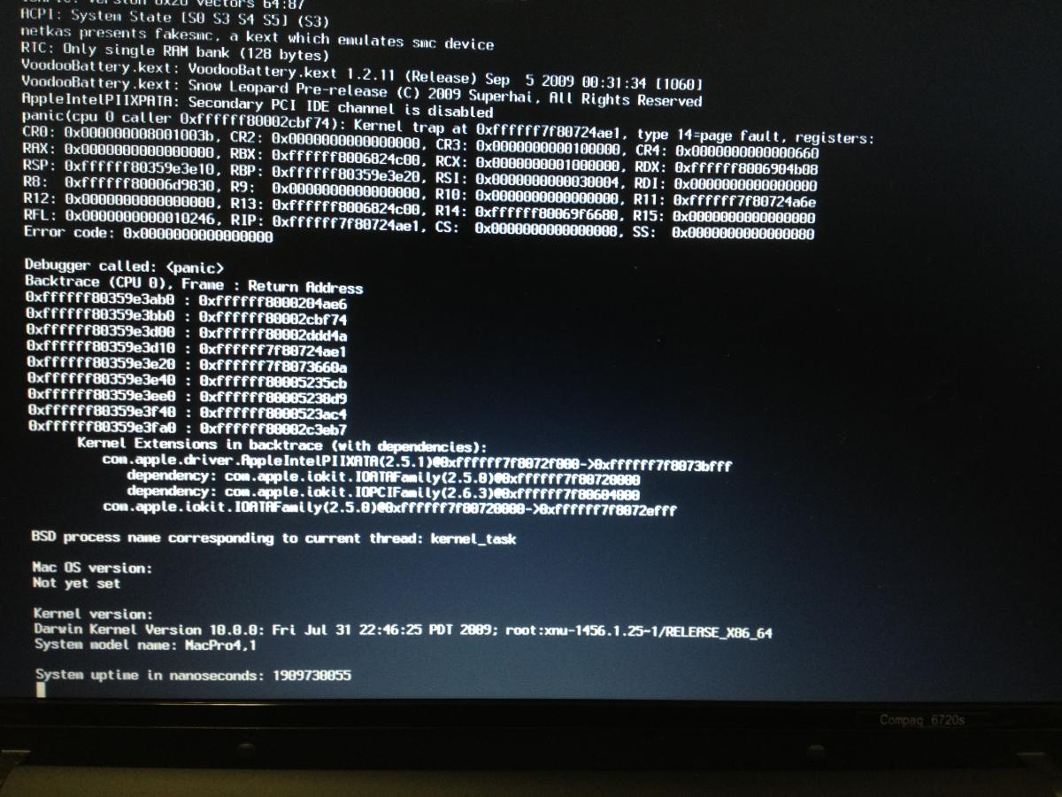

Gianluca 84 Posted February 16, 2012 Share Posted February 16, 2012 Hi all, I installed osx86 a lot of times on my PCs but I'm having problems with an HP Compaq 6720s. I'm using the Hazard Snow Leopard. The installation works fine but on the first boot I get the kernel panic in the attachment. Link to comment Share on other sites More sharing options...
TH3L4UGH1NGM4N Posted February 16, 2012 Share Posted February 16, 2012 Your KP is backtracing to a kext that is used to load IDE. I suggest you either disable the IDE interface in your BIOS if you're not using it (I'm assuming you're not using anything legacy that even needs it), delete the kext if you truly don't need it, or follow this topic http://www.insanelymac.com/forum/index.php?showtopic=186609 Link to comment Share on other sites More sharing options...
Gianluca 84 Posted February 17, 2012 Author Share Posted February 17, 2012 Ok, I'll try but I don't know how to replace it. I must boot in -s? Link to comment Share on other sites More sharing options...
