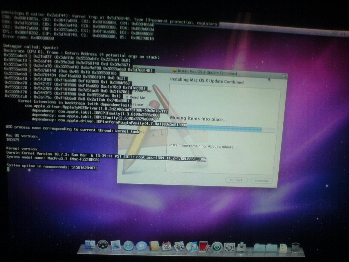

dillu Posted January 28, 2012 Share Posted January 28, 2012 Hi All I am a newbee and recently i updated my mobo to Intel DH67BL and CPU to i3 2100 and memory to venegence 1600 mhz ddr3 8GB. I installed successfully 10.6.3 retail dvd using [url="http://www.insanelymac.com/forum/topic/279450-why-insanelymac-does-not-support-tonymacx86/"]#####[/url]+[url="http://www.insanelymac.com/forum/topic/279450-why-insanelymac-does-not-support-tonymacx86/"]#####[/url] method. resolved sandy bridge kernal panic by using updater help from tonnyosx site. but still i am getting appletymcedriver Kp can somebody help me i am attaching kp screen for the reference. Thank you Link to comment https://www.insanelymac.com/forum/topic/275170-help-kernal-panic-updating-to-1068-on-intel-dh67bl/ Share on other sites More sharing options...
PookyMacMan Posted January 28, 2012 Share Posted January 28, 2012 Try booting a few more times and see if the same panic happens. If not, try the following: Boot in single user mode (at the boot prompt, press a key and type -s and then press enter). Once there, type the following commands: /sbin/mount -uw / rm -R /System/Library/Extensions/AppleTyMCEDriver.kext exit You should be able to boot okay. Link to comment https://www.insanelymac.com/forum/topic/275170-help-kernal-panic-updating-to-1068-on-intel-dh67bl/#findComment-1790287 Share on other sites More sharing options...
