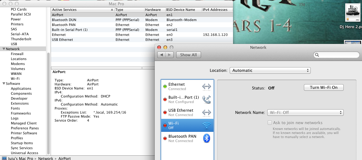

SunLizard Posted June 22, 2012 Share Posted June 22, 2012 PookyMacMan, It seems to be recognized in software (see Screenshot) but I can't turn on the device in network settings... I've discovered there is a chipset difference between the 851N and the 851ND... so perhaps the DeviceID change you suggested (that I did try) might not fix my issues. I looked at trying to fool around with the DSDT file to add the device ID there but, quite frankly, I get lost in that stuff quite quickly, I'm afraid. Thanks for your response though, it was something I hadn't tried. Take care. Link to comment https://www.insanelymac.com/forum/topic/274409-tp-link-tl-wn851n-connection-dropping/page/2/#findComment-1828617 Share on other sites More sharing options...
PookyMacMan Posted June 23, 2012 Author Share Posted June 23, 2012 Don't worry, I'm still confused by (a lot of) DSDT too. What you need to check is the WiFi branch under the network branch in Sys Info that you selected in the screenshot. That Network section only shows the software interfaces, meaning they can exist even if there is no hardware linked to it. Check WiFi and see if it gives any hardware info (otherwise it'll just give you software info). Boot in verbose mode also, and see if you get any errors about IO80211Family not loading correctly. 1 Link to comment https://www.insanelymac.com/forum/topic/274409-tp-link-tl-wn851n-connection-dropping/page/2/#findComment-1828873 Share on other sites More sharing options...
SunLizard Posted June 23, 2012 Share Posted June 23, 2012 Thanks. Got it solved (in 10.7.3 at least....) See the TP-WN851ND link in topics. Ta for the help! Link to comment https://www.insanelymac.com/forum/topic/274409-tp-link-tl-wn851n-connection-dropping/page/2/#findComment-1828911 Share on other sites More sharing options...
