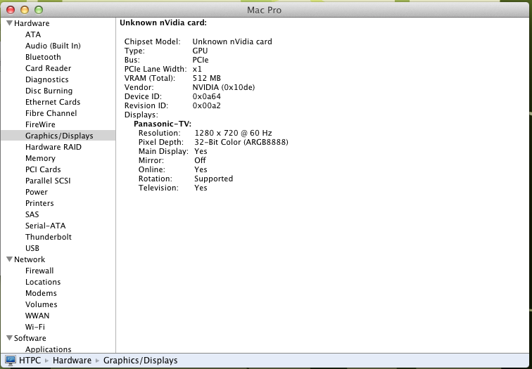

buoo Posted December 7, 2011 Share Posted December 7, 2011 Chameleon says (on boot up): VESA v3.0 14MB (NVIDIA) - Maybe that could be a mistake. About this mac, more info , GraphicsDisplay what do you read here? Link to comment https://www.insanelymac.com/forum/topic/273202-a-few-problems-with-my-htpc-zotac-zbox-hd-id33-1072/#findComment-1776476 Share on other sites More sharing options...

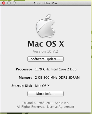

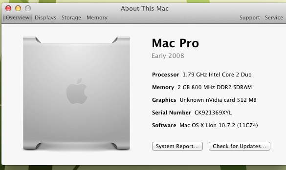

stasicasi Posted December 7, 2011 Author Share Posted December 7, 2011 Other thing, is it possible to activate an overscan function for boot process? There's such a big black border (ya I know, this is cosmetic ) Now i configured my HTPC as a MacPro 3,1 and updated with Chameleon Wizard my smbios.plist - still no iCloud support with the same error message. Link to comment https://www.insanelymac.com/forum/topic/273202-a-few-problems-with-my-htpc-zotac-zbox-hd-id33-1072/#findComment-1776478 Share on other sites More sharing options...

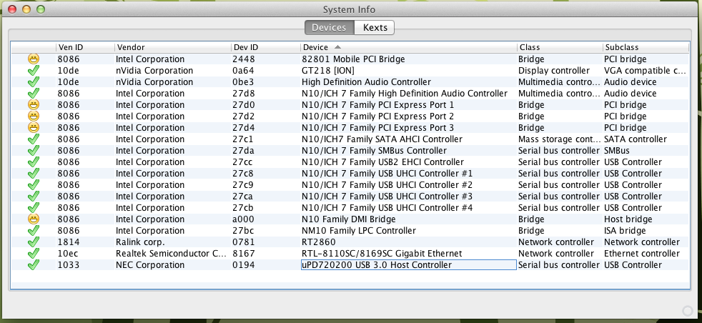

stasicasi Posted December 7, 2011 Author Share Posted December 7, 2011 So, now I'm a bit confused. I found a System Info Tool, and this shows me my hardware. And this differs from that hardware I thought it should be in my HTPC. NVidia G218 instead of G210, maybe that's the problem of the 1080p playback? Ralink RT2860 Network Adapter? Is that my WLAN card? RTL-8110SC instead of a RTL-8111 - Causes this the missing jumbo package support? Should I try this: http://www.chipdrivers.com/chipset/network-adapter/realtek/rtl8110sc/apple-mac-os-x-intel-based/ ? nVidia and Intel Audio Controller. nVidia, HDMI Sound - does this work!? That would be great Hm... Link to comment https://www.insanelymac.com/forum/topic/273202-a-few-problems-with-my-htpc-zotac-zbox-hd-id33-1072/#findComment-1776498 Share on other sites More sharing options...
