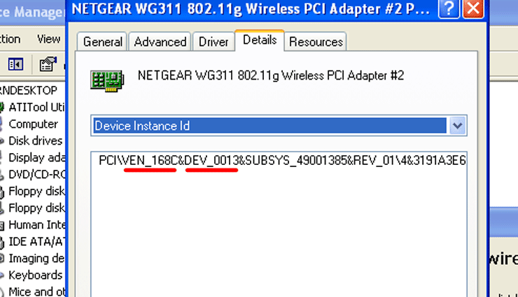

TNCEKM Posted September 12, 2006 Author Share Posted September 12, 2006 In OSX, go to System Profiler (in Utilities folder). Click on PCI cards on the left and find your WG311 on the right. Verify that the Vendor id = 0x168c and the Device id = 0x0013 Okay...I'm at home now and I got home and checked the system profiler to verify this, however, it doesn't show this in my system profiler in 10.4.6 JaS. I went ahead, however, and checked in WXP and it is correct (see screenshot below) So, I refrained from going further in the process since I'm "assuming" that since the system profiler isn't recognizing the device something else is up. I had to clean install last time from messing with it a bunch, so I'm going to be a bit more cautious this time around...Is there something I need to do to make OS X "see" the card in system profiler before I do the modifications to the kext? clean installs are the last thing I need to be doing with the homework load I have this week, haah. Any advice? Thanks! Link to comment https://www.insanelymac.com/forum/topic/27275-have-searched-but-come-up-short-help/#findComment-186334 Share on other sites More sharing options...
