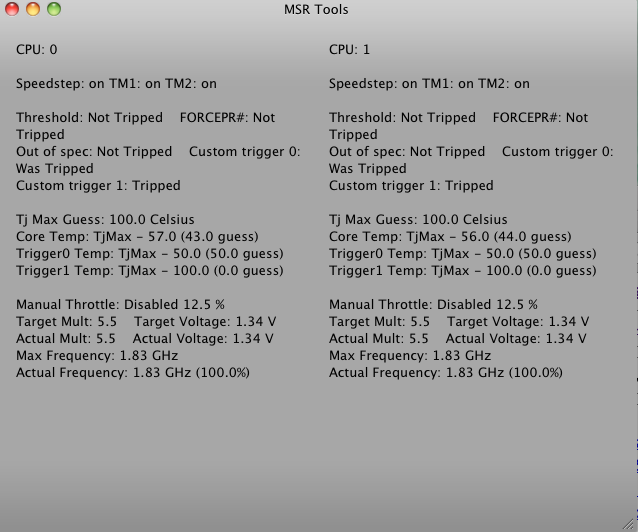

Onishi Posted November 22, 2011 Share Posted November 22, 2011 first of all THANKS to developers of xnu-speedstep-air Reid. But I've got a question... My CPU is Core2Duo T5600. It's Voltage Range is 1.0375V-1.300V. But when Clock Speed is 1.83 GHz, voltage is 1.34V. And I think if CPU has higher voltage than it's max value it's not good and make my CPU warmer than it should be. How can I fix it ? I have seen AppleIntelMeromProfile.kext, but I don't know where I can get it and what I have to do ??? Please Help. Link to comment https://www.insanelymac.com/forum/topic/272559-speedstep-via-xnu-speedstep-air-gives-high-voltage/ Share on other sites More sharing options...
